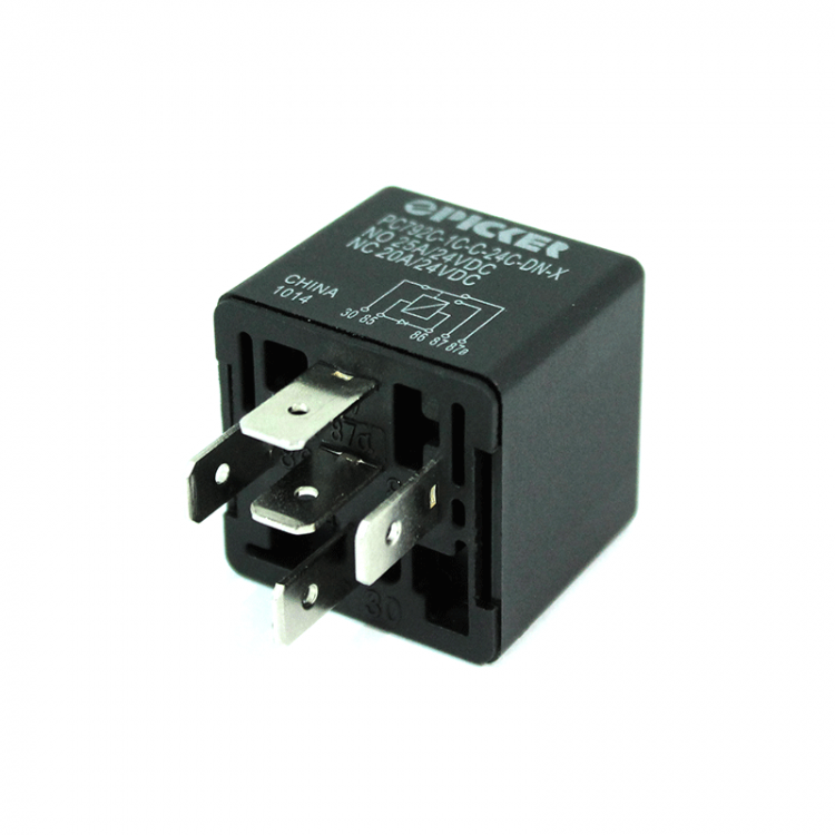

   If you want to keep the remote start operational but disable the other system - you could run a bypass circuit using a relay. It would be easy to set it up so that the hood switch circuit is broken only when the engine is on. When the engine is off, the relay would close the circuit, allowing the remote start to work. This may help keep the security system fully functional as well. You could even put a manual bypass toggle switch on there too, so that you can easily enable the system if you wanted to.
The whole setup would cost about $20, and would take an hour or so to hook up.
