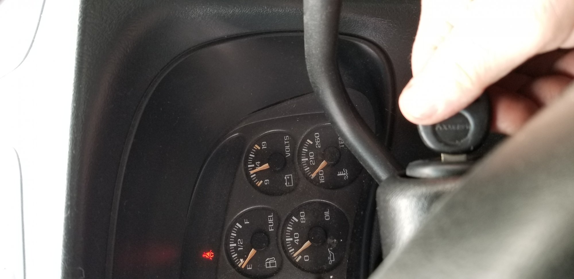

The truck was running fine, one day it just stalled while driving.  Would not start, towed it home and put it on the trickle for a day.  Started right up and I ran it for 10 days and it did again.  towed it home tried the trickle charger again, will not start.  Replaced the Alt. and had the battery tested, said it had a full charge with no bad cells.  Fuel pump bad?   Would it have run for 10 days after the first episode if so?  HELP!!! thanks!!!!

I'm sure you know that you meant volts, not amps, but that aside, you need in the neighborhood of at least 12 volts cranking for the electronics to fire the engine. Given that the instrument panel gauges can be notoriously off by a fair bit, I would have your battery load tested, a full charge on an old battery can be misleading. How old is your battery by the way? After you get this sorted out, at the very least invest in a voltmeter, that will give you at least a starting point, resting voltage should be at a minimum of 12.4V, 12.6V more better.
Yes Volts.  Battery about 3 years old.  Had it tested at the local store.  549 cold cranking and said all cells were good. Told me it was charged.  Why would it run for 10 days after the first incident and then do it again?   Thanks for your help all...
