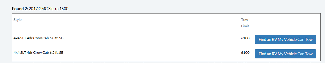

 I go to camping world website enter my vehicle VIN and it says I can only tow 5500 lbs.
My guess is their website is conservative and give you the lowest tow rating for that vehicle regardless of what configuration.  I tried myself and put in my VIN and it found two, so it's clearly not VIN specific but just to know what type of vehicle you have. I have 6.2 and tells me my tow limit is 6,100, when per the owners manual it's 9,100

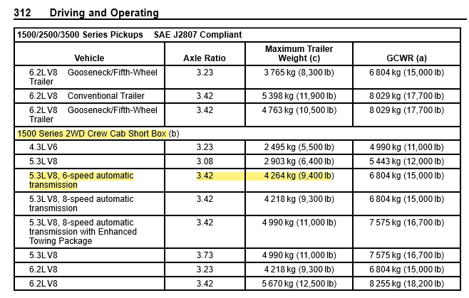

Per the owners manual your truck as described has a maximum trailer weight limit of 9,400 lbs. with a GCWR of 15,000. Your door jam sticker will give you axel ratings and maximum payolad as well.  Strictly by the numbers, you can tow 300 lbs more than I can with my 6.2.

Looking to purchase a travel trailer and I'm trying to determine my towing capacity.  All the numbers make my head hurt!  I read the owners manual and it looks like I can tow 9100 lbs, I go to camping world website enter my vehicle VIN and it says I can only tow 5500 lbs.  Really confused and hoping someone can help me determine my tow capacity.  Here are my truck build sheet specs:

Your Maximum Trailer Weight is 9,400 pounds.  Your GCWR is 15,000 pounds.
To find out how much your rig weighed from the factory, subtract the maximum cargo capacity from the GVWR.  Cargo capacity is found on the Tire and Load Information Label inside the door or door jamb (page 239).
Just because it says 9,400 pounds doesn't mean you can pull 9,400 pounds.  Read your owner's manual, I did!  Start on Page 300.
