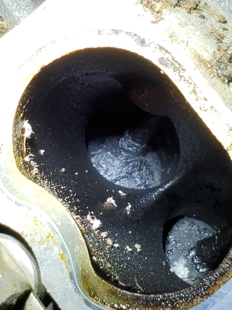

3 hours ago, steelcity said:
 This problem is more prevalent with intake valves in engines utilizing direct fuel injection, where the fuel is injected directly into the combustion chamber rather than into an intake port. With port injection or carburetors, the fuel passes over the backs of the intake valves and both cools and cleans them, reducing the likelihood of coking. When deciding whether an oil catch can is right for you, weigh the negatives against the positives.
Technically this isn't coking. Coking is hydrocarbons heated to the point of hydrogen disassociation leaving nothing but carbon behind. The backs of intake valves in a running motor come no where near hot enough to coke. Not even in a GDI motor. Even in a refinery a catalyst is required at temperatures near 950 F. Sans such a catalyst coking temperature exceed 1400 F.
If it were 'coking' no fuel detergent would wash it away. Speaking of detergents...they are present in you motor oil.
What happens is more akin to leaving the lid off a can of shellac or the creation of amber from tree sap. A coating of oil bakes during the hot soak repeatedly building up layers. Motors that live on short trips and use oil can have issues. Not so much with motors that use little and who's mile are more highway.
This is the intake tract of the afore mentioned GM Ecotec 2.4/I4 whose PCV system plugged and rings collapsed and consumed oil at a peak rate of a quart in 600 miles. This one needs a can. Short tip motor that uses oil. This cleaned up with solvent and a wooden scrapper. 90K on the clock if I remember correctly.
