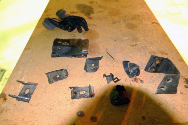

I have the CST 4.5" , my second CST kit. I ran there 4" kit on my 2013. The older kit was much simpler and I chose it due to the fact it doesn't widen the front track width. The new 4 1/2" kit is more complicated since it relocates the upper control arms. Not saying it isn't a nice kit, but there is a lot more cutting then the old kit. I really can't see going back to stock very easily since you cut the control arm pockets and droop stops out. With all that said, I would still do the CST due to the fact I don't like the front end pushed out wider then the rear. I would rather have the option of choosing my offset with the wheel choice..
Here is picture I took of what needs to be cut off the truck when installing it.
iv talked to cst a few times today and there is more cutting than I first thought.  But I'm still planning on going with this set up.  I'm hoping to drive this truck for as long as possible and want a kit that will stand the test of time.
