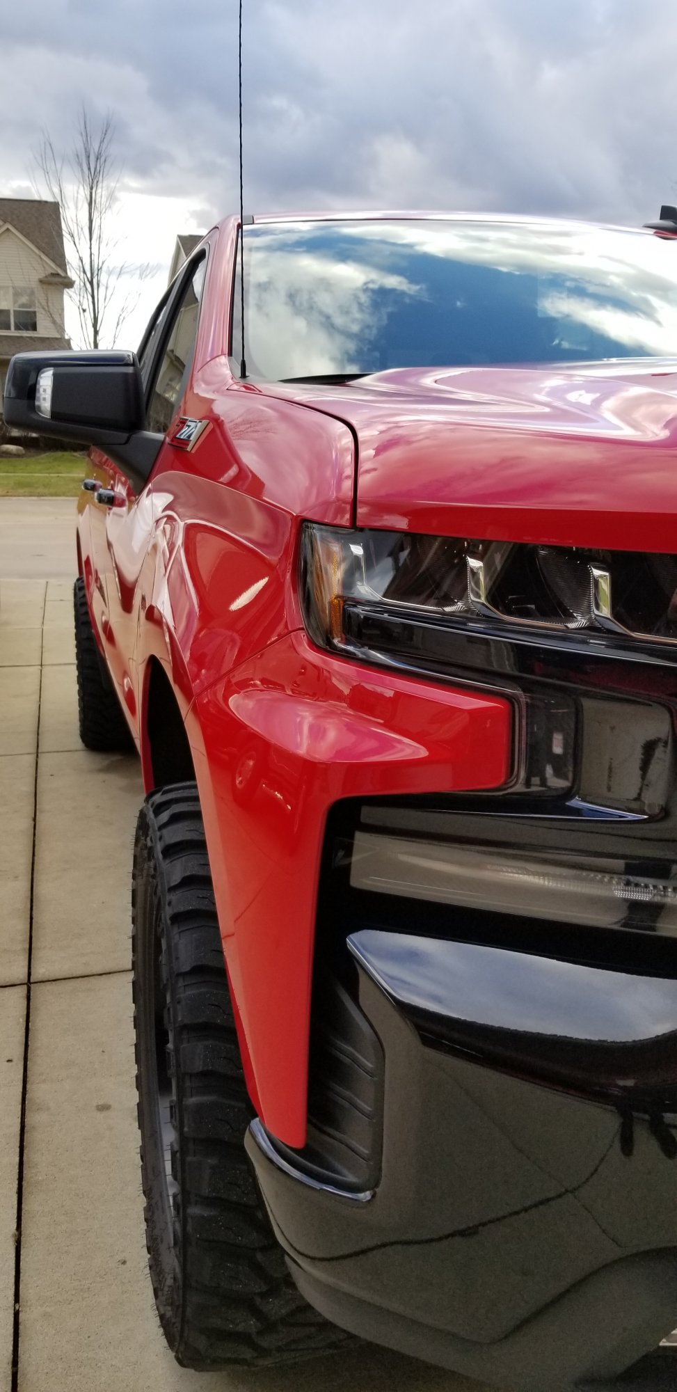

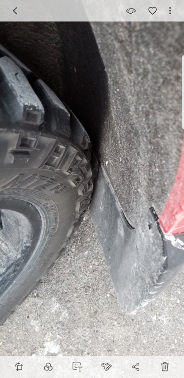

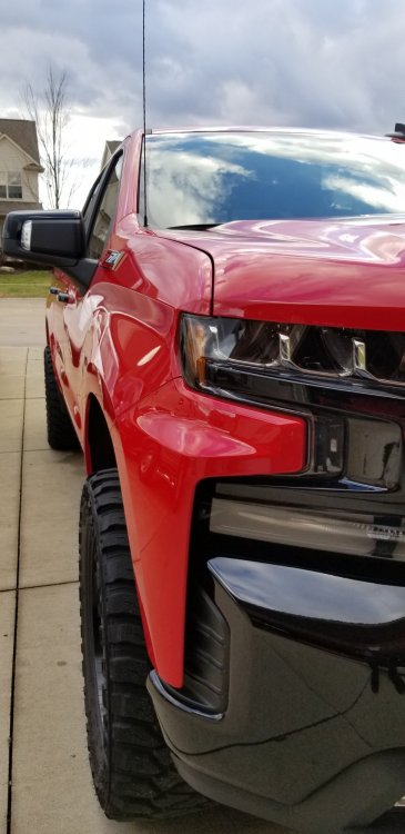

You will rub with that setup.  Leveling the front of an RST would make the front about the height of a stock Trailboss.  I am running a 305/55R20 (33.5x12.5) on a 20x9 0mm offset rim on my stock height Trailboss and it is rubbing for me slightly.  A 20x12 rim has a lot more negative offset, sticking the tire out more.  You need to run a smaller width rim such as a 20x9 in order to fit a larger tire on the truck but your biggest tire will probably be a 33x11.5 without rubbing, although it may vary slightly depending on the manufacturer specs of the tire (some are smaller or larger than the size printed on them).  Below are some pictures for reference of the rubbing and how far they stick out.  Any other questions, let me know.
