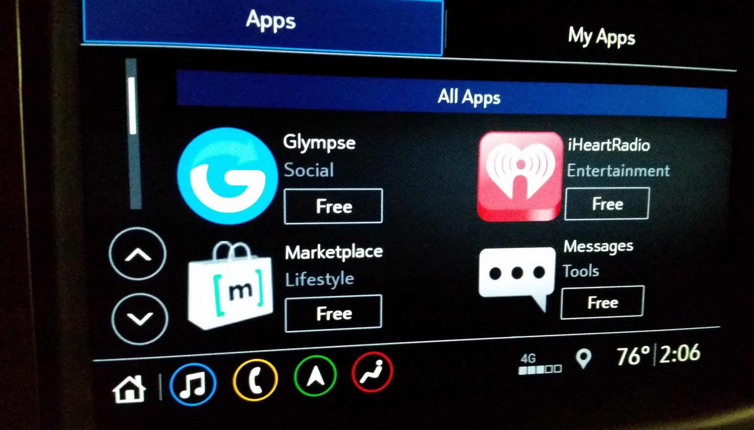

Was Finally able to get the "MESSAGES" App restored after the 803.1 update!
23 minutes ago, Clay00024 said:
How?
I had to contact the Chevrolet Executive Resolution Team,  ([email protected]) and request it be restored.  The Messages App is no longer supported, but if it was  previously downloaded to a Profile it was not suppose to have been deleted with the update!
Get your profiles configured because the Message App will disappear from the Apps Drawer in a few days.
Done and Done.  I have even added it to the "Guest" profile.
