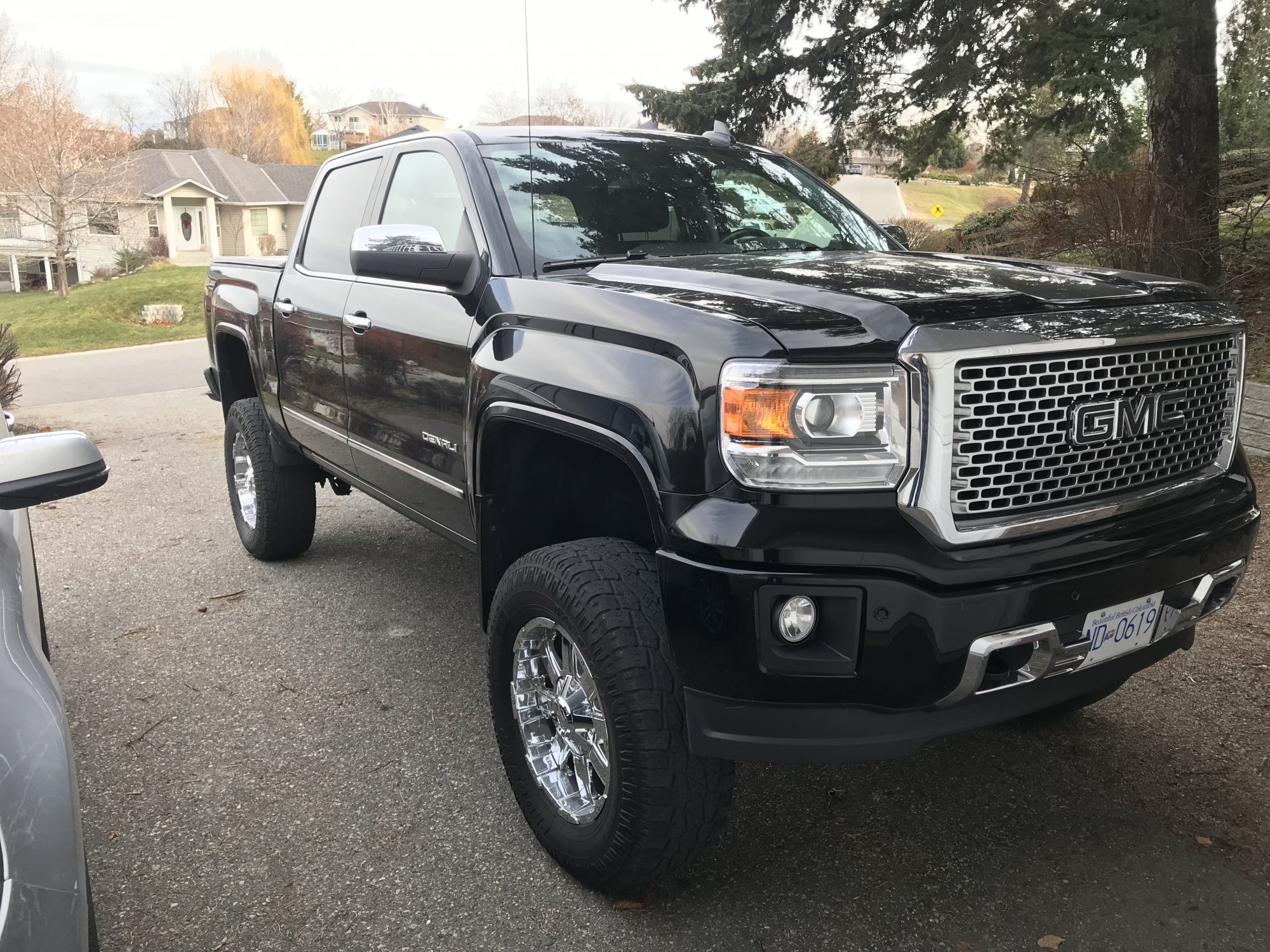

I couldn't either. This is her and other than this issue I just came up against, couldn't love the truck more.
IMG_4951.thumb.jpeg.9630e622540dcc4172381eccf935a2b3.jpegIMG_4872.thumb.jpeg.f303f94692be43e04da7d5326b644d93.jpeg
