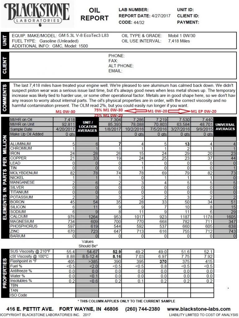

Added AMSOIL to this spread sheet.
Universal Averages and AMSOIL are 5W30.
Red Line is 0W20. Running lighter if also running colder isn't hurting wear metals at all. That said if one insist on the 207 F thermostat and no additional controlled coolers then 5W30 makes perfect sense. If I had a 5.3...I'd run 5W30 OR install more cooler OR lower the thermostat set point. Lot's of ways to skin the cat and make it work.

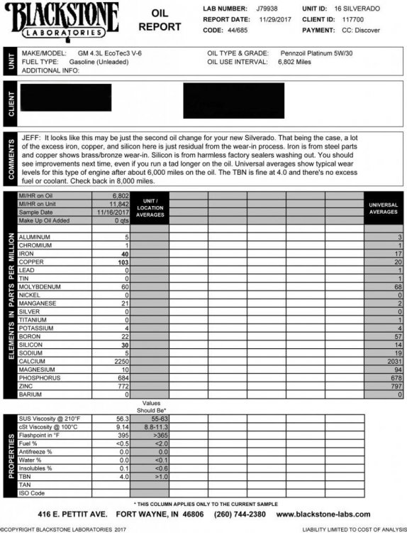

Here is uao on the ecotech 4.3 v6 using Penzoil Platnium. The miles are low on the engine. Blackstone list slightly different universal averages on the 4.3 v6 than what you have posted for the ecotech 5.3 v8

Thanks. I'll update my sheet.
The more samples I see the more comfortable I'm getting with Peppers results and the more I fall in love with Red Line. What Dyson found alarming Blackstone sees as 'in the ball park'. Funny how the alarmist who howl at the moon over Direct Fuel Injection concern over fuel dilution are taken back step when the results are in. Labs don't seem to confirm the concerns nor are the water levels alarming at 1,000 ppm  (0.1%). Looks like I could put my K&N back in service as well. Silicon levels are fine.
This is what I get for a knee jerk reaction to 'expert' advice WITHOUT or in absence of a statistical point of reference. Sad part is I know better and fell for it anyway.
SO much for 'MODERN MOTORS DON'T REQUIRE A BREAKIN'. Seems labs say other AGAIIN.

I was wondering myself about those numbers you posted?  Not the universal averages I have from Blackstone?  Run 0W20 actually three different brands of leftovers and I wouldn't run anything other than 0W-20 less wear, better miles to gallon ...great water...no gluten!  I want more..........0W-20
