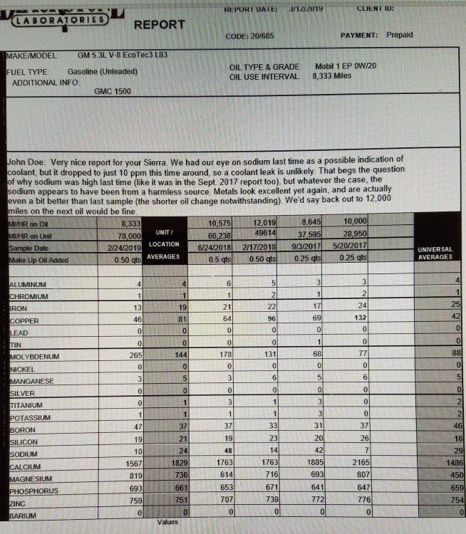

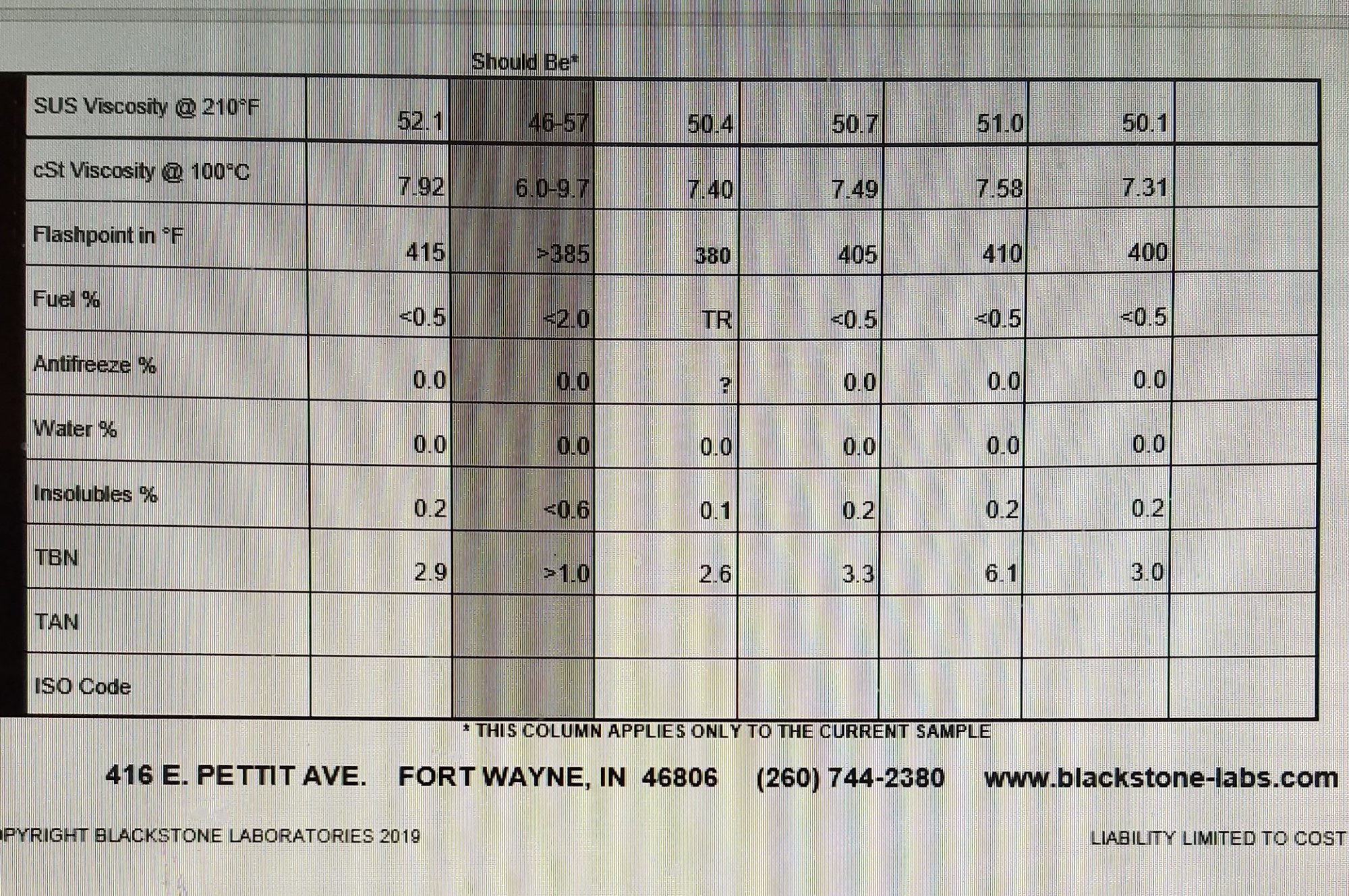

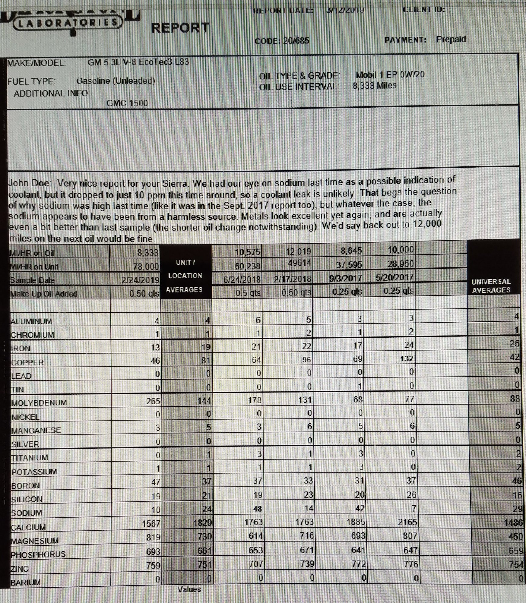

Here it is FOLKS.....0W-20 ran as HOT AND LONG AS I LIKE IN PHOENIX, AZ  the last change was 3qty different 0W-20's  Mobil,Amsoil and Quaker State.  I go by price really? Which is why I was using  3qty different mfg's I had laying around.  I got the Amsoil at a discounted price so I used it?
Well, the first report was displayed for you "goofballs" only thing I heard was...your killing the engine?  Look at that Copper?  DYSON,DYSON...Terry DYSON NEEDS TO DO YOUR ANALYSIS...yeah OK?
Let us fast forward to now......like this is my first time in a WAL-MART?
I will probably go single digits on Iron within next 2qty oil changes.  I will probably drop the copper down into the teens low 20's....finally...just about settled in?  All of these numbers exceed the "universal averages"
So..I guess this Ol' Cogger ain't gonna be blowing up da engine Hey?  Grumps....Check the TBN's  you like that?  I can go 10-12K all day in this heat...actually?  I think it likes it & I like 0W-20 too!
Honestly, this is for us Americans using our liberties and hopefully learning from one another which is made possible on the Internet....I did input the 49,614 number as Blackstone never entered it back in the day?

Copper, Pepper 4.80 ppm/1K miles              Copper, Mook   5.52 ppm/1K miles
Iron, Pepper 2.40 ppm/1K miles                    Iron, Mook   1.56 ppm/1K miles
Alum, Pepper 0.40 ppm/1Kmiles                  Alum, Mook   0.48 ppm//1Kmiles
Vis Pepper 8.5                                                  Vis Mook   7.9
Blackstone likes it use ppm per thousand miles as a benchmark for were. That's the only reason I broke it out that way. Seems a fair standard for comparisons for differing OCI values don't you think?
Ya know what's impressive? Your fuel and water dilution numbers are off the hook. What was that again about DI motors and crazy fuel dilution values? :rolleyes: I like data. Keeps the Trolls in check. Good job sir.
Yea Mook, I like your TBN. Your less than 5K miles behind me. Ever consider tanking a 5K sample? BTW, what does Blackstone charge for this level of service? You don't run any enhanced cooling do you?

Nice Breakdown!  I still do think that DI engines are more apt to fuel dilution...I am also taking a BOX of MORTON SALT with Blackstone's Fuel% numbers for a number of reasons.  I have seen your thread on the Cooling/MPG's interesting no doubt.  I was worried when I bought Truck about Cooling issues and how to combat.  I have not seen anything to warrant it though and GM does like these engines on the hotter side.  Plus, adding extra fittings and hoses accessories electrical draw etc.etc. I am already cooking the battery like clockwork every 14-15 months?
My reason for Catch Can install was mainly for fuel dilution.  I am a hardcore BG proponent and keep my DI system "CLEAN" seems to be working?  I will probably never take a 5K sample if I am looking good at 10K+ during winter and Summer?  Blackstone charges extra 7.00-8.00$  for total 38.00$ ish?
If I keep trending like I am...I might possibly have a engine outlast a FERD engineered engine?  LOL....god I can't stand FERD!
