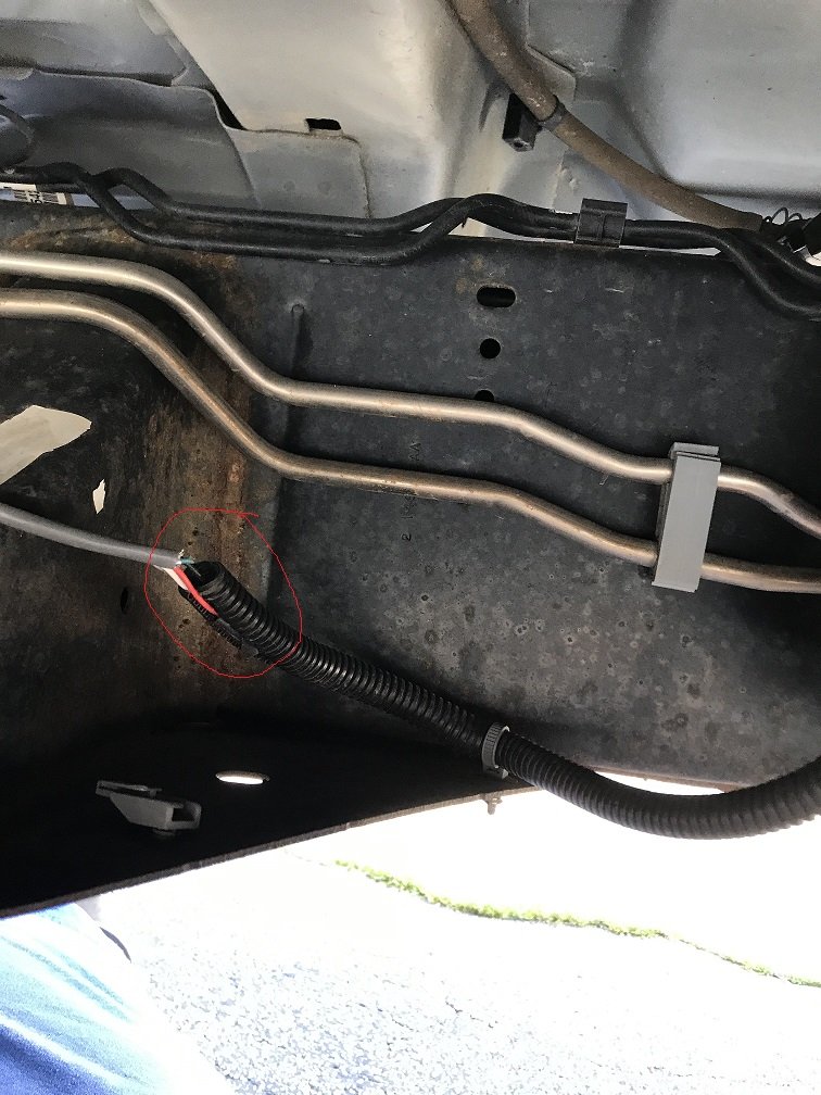

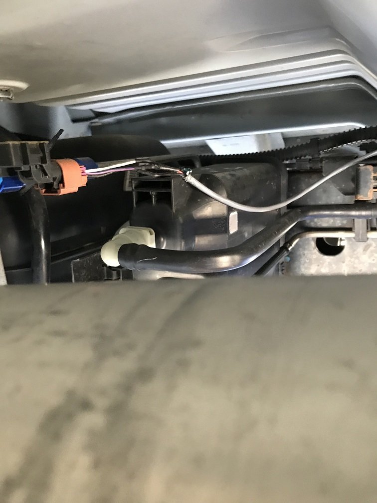

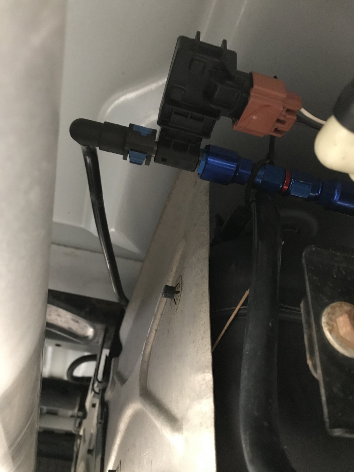

No it doesn't move it that much.  It's raining today so I'll craw under there tomorrow and snap some pics.
Edited by JONBLARC7
The red circle is the clip you pull the flexible fuel line out of.  The green is the stock connector re soldered in it's new location.  I just went to Lowes and bought a (4 in 1) 22 gauge wire and only used 3 of the 4 wires.

couple more showing how far it is from the drive shaft
Was it not an option to simply buy the factory GM lines for Flex Fuel and put the sensor in the OEM spot (well, OEM spot for a 5.3L FF truck, I get that GM never offered it on the L86).  I'm not understanding the need to relocate the sensor to another location.
Yes you could do that but then you have to replace all the fuel lines from the fuel rail to the gas tank because nothing matches up.  This literally took me maybe 20 mins to add to the truck.  And that includes me have to crawl out form under the truck to clean off.

23 hours ago, JONBLARC7 said:
one more
Thanks for the pics, It doesnt look too terribly close to the driveshaft. Im sure if it bothered me i could get creative with some 90 degree fittings. But this is definitely the way I plan on doing it as opposed to $250+ kit. Instead of tapping the harness id probably spend a couple bucks on an extension since I have terrible luck with splicing and soldering.
I would have bought that too.  But I was in a hurry for some reason.  I should have bought that extension too but it's been on there for a few months now with no problems
