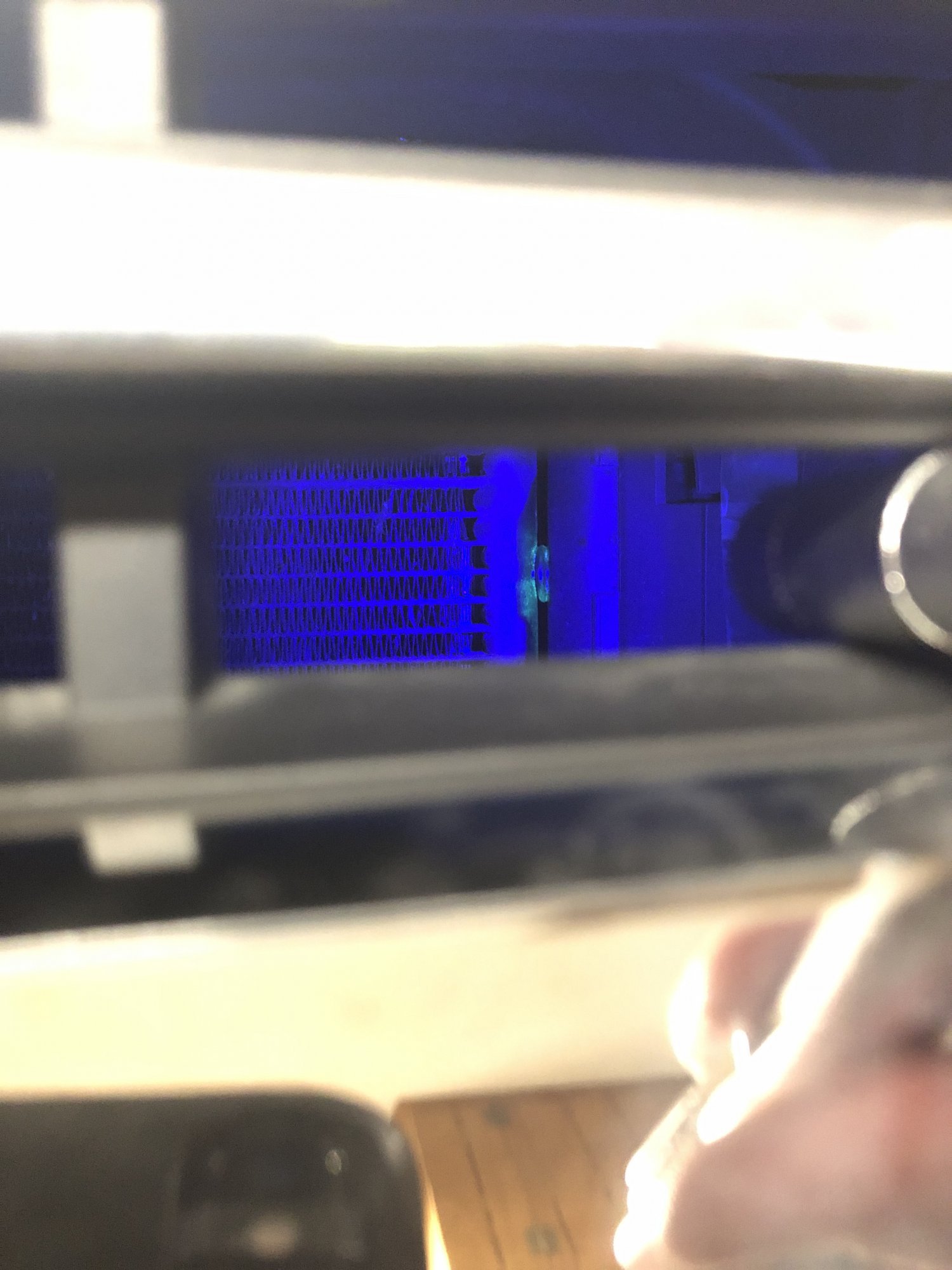

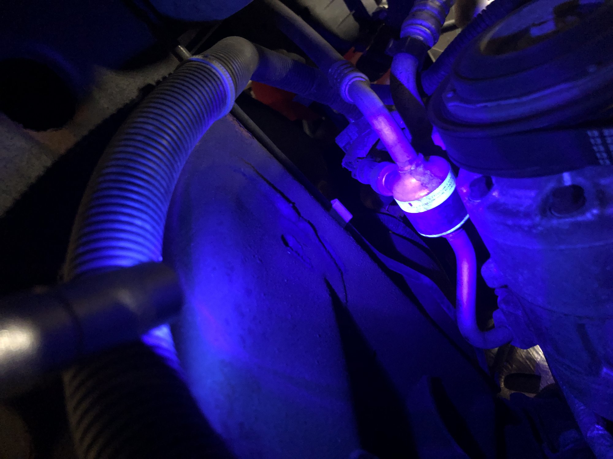

Bingo, but not a prize I wanted to win! Gotta check the lower line still. All looks good from up top.
Lines look good but no bracket. It’s a14 and never been in for this so not surprised. No leaks so would be preventative. Anyone know the current part number for that?
