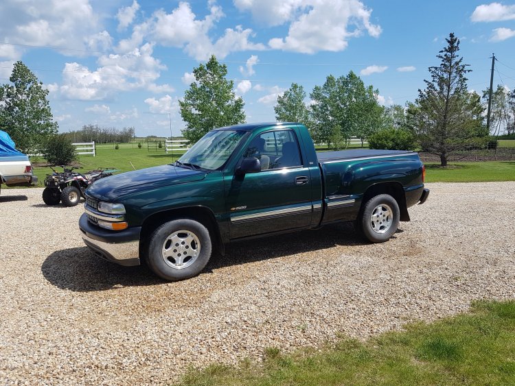

As the title says, I need some advice from people who have lowered their trucks. It's a 2001 silverado 2wd stepside. I'm thinking of 20 or 22 inch rims but I dont want any rubbing. Max width would be great too cause I'm going to be twin-turboing it. Also this is my first truck so I don't want to be doing any fender tubbing or anything else permanent. Any help would be appreciated!
Edit: I haven't lowered it yet. Kinda forgot to mention that ?

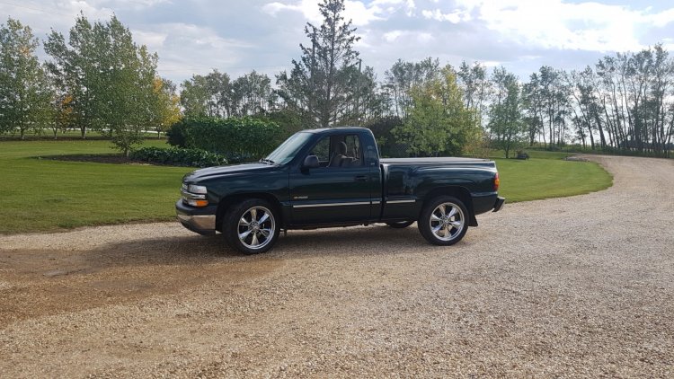

Update: I bought some sweet american racing 22s yesterday. They have 305/40/22 tires all around. I love the way it looks ?. They only rub at full lock. Got the whole set for 850$!!
