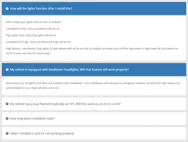

I wonder how this would work with the auto high beams?
Just got my truck this past Saturday.  Noticed you can't run auto highs if fogs are on.
I'd love to know this as well, I hate that I can't run the fogs with Auto.
According to their website, it has no effects on Intellibeams.  Watch the videos for your truck model(s) and read what's on the webpage for the product (everything above the reviews section).  The 2019 1500 series video was simple enough.  Remember to follow the pin layout and not just the wire color as noted in the video.
