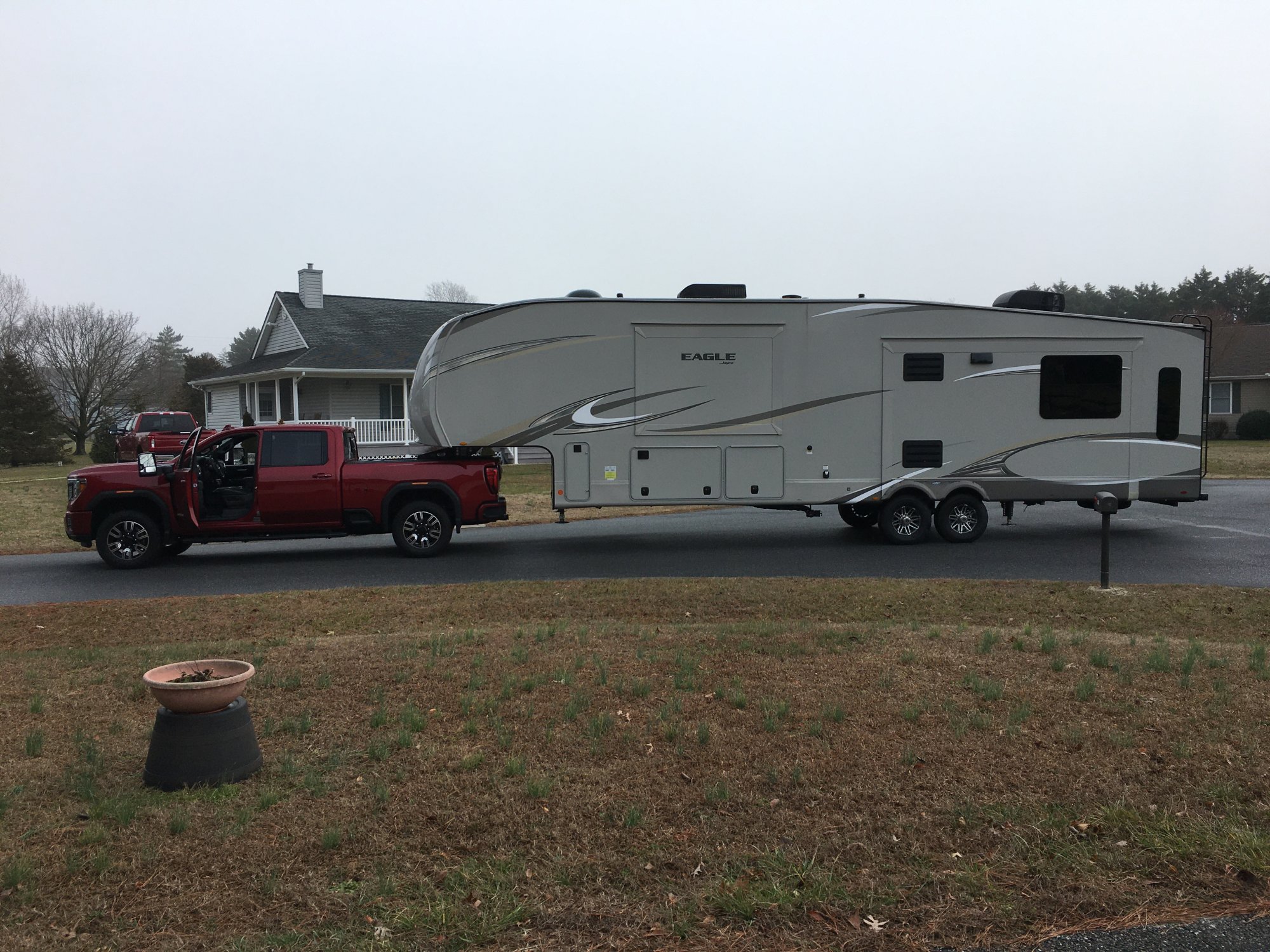

Just installed Demco adapter plate 6333 with my Pullrite 2700 slider on my 2020 3500 AT4. Rides great. Lots of trips planned when it gets a little warmer.
