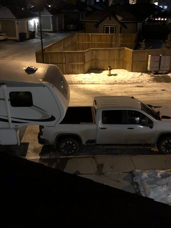

Just picked up our new to us fifth wheel. Here’s the space in box hooked up to my 2020 Chevy 2500HD reg box
