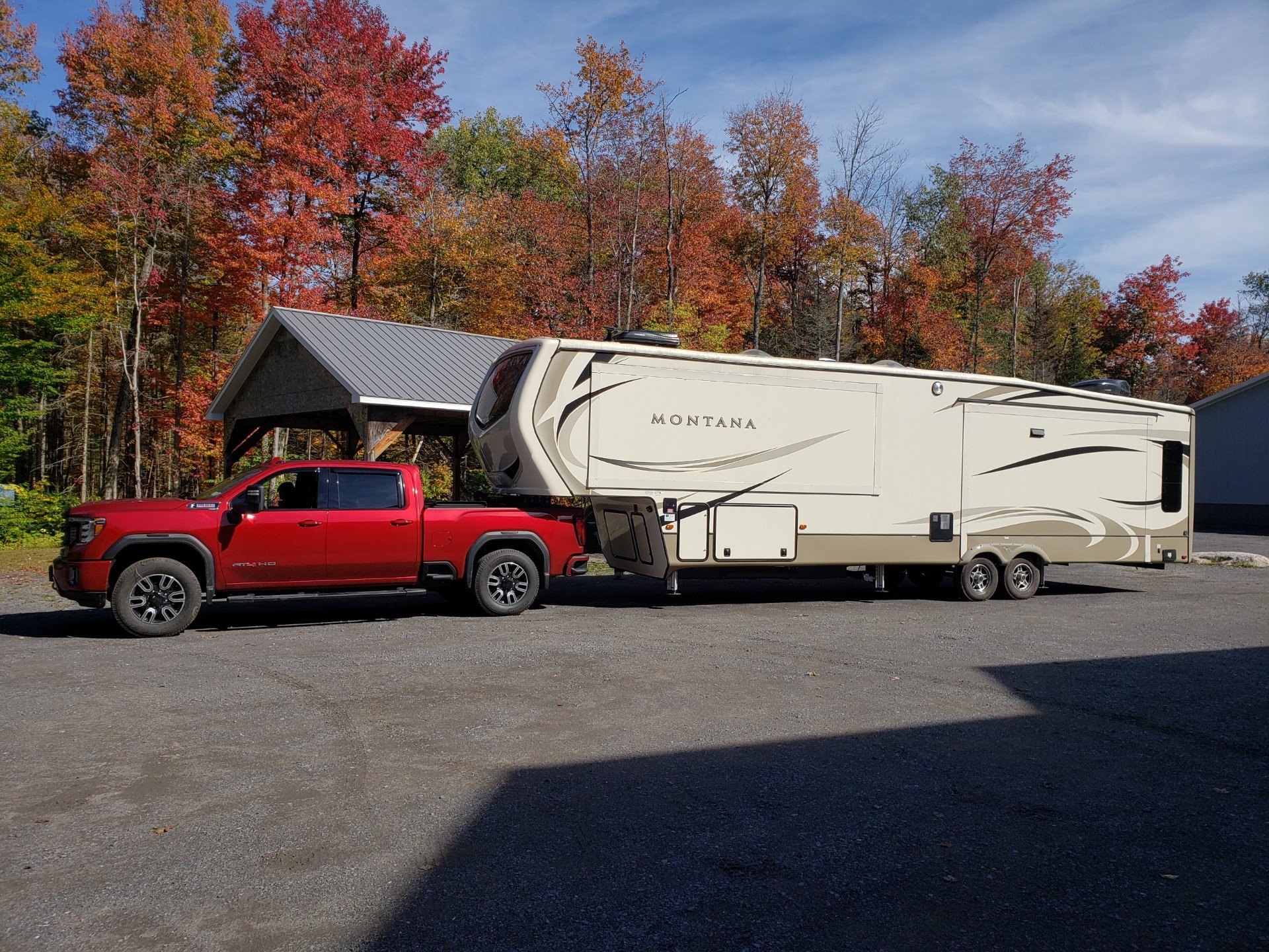

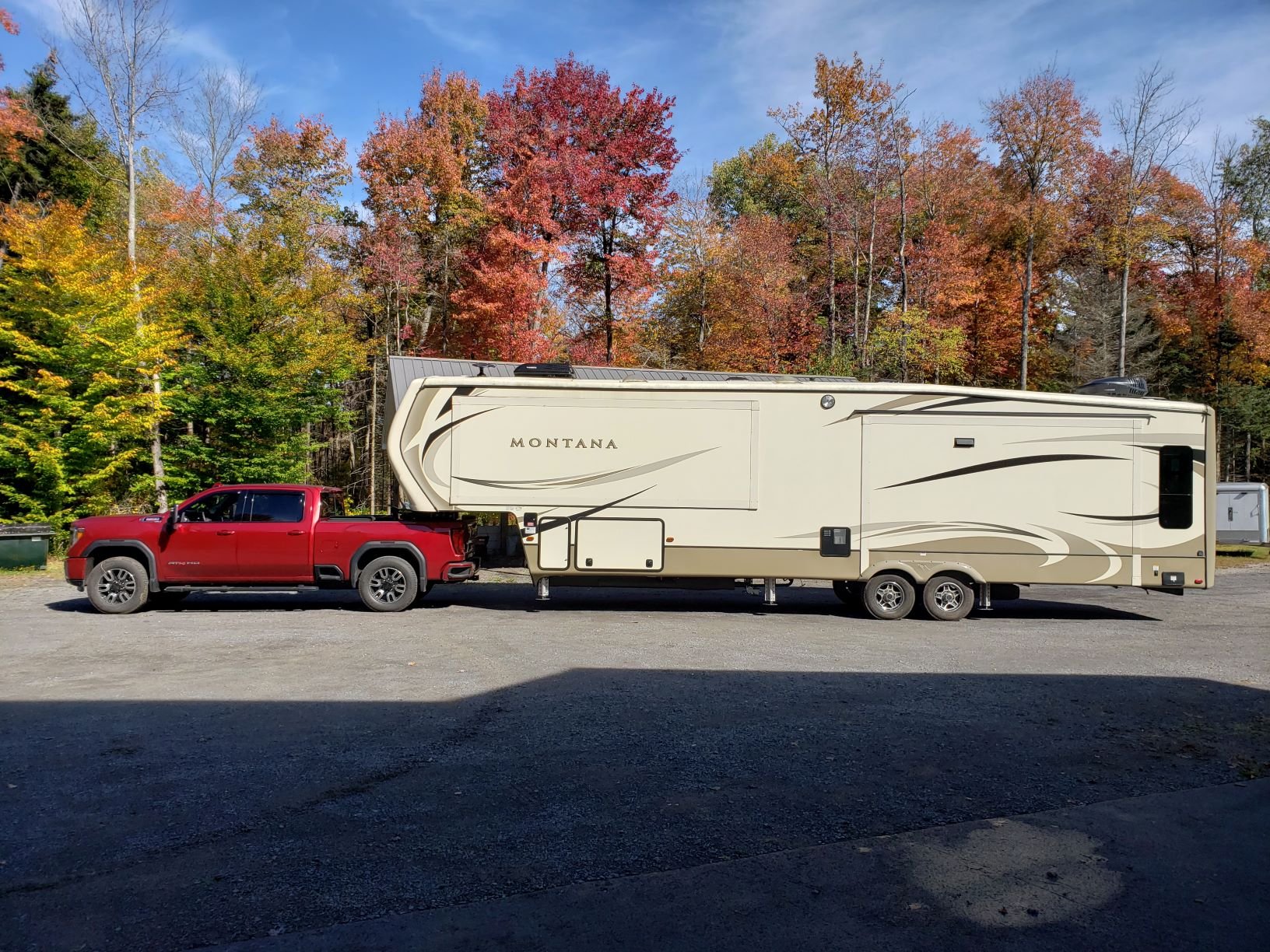

Here is a photo of the truck and trailer hooked up. Also a photo of the pin portion in place on the trailer. I dont have a picture of the hitch in the bed but will put it in over the weekend and post it. 85299ea869fa3eef29241566b4d26987.jpga81b2254e0a9a58203e934e9975b4415.jpg
All my goose necks and fifth-wheels have been closer to the cab then that. That looks a little odd. I would want some more weight over the rear axle.
His pinbox just sticks out from the front cap more than others, especially more than a momentum which I have. Weight is still connected and pushing down on the ball.

It just looks like it could be a ft closer. All mine were not extended out like that. They were directly under the camper, not extended like  that. I’m sure there’s a reason, just looks off.

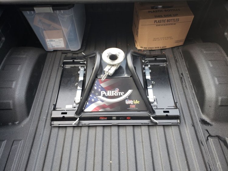

Got some dims. From front of bed to center of ball is 50". From center of ball to inside face of tailgate 32.25". Also attached a picture to show position. 22082c9332be9c2e7aa9fb19f93f1ed5.jpg
