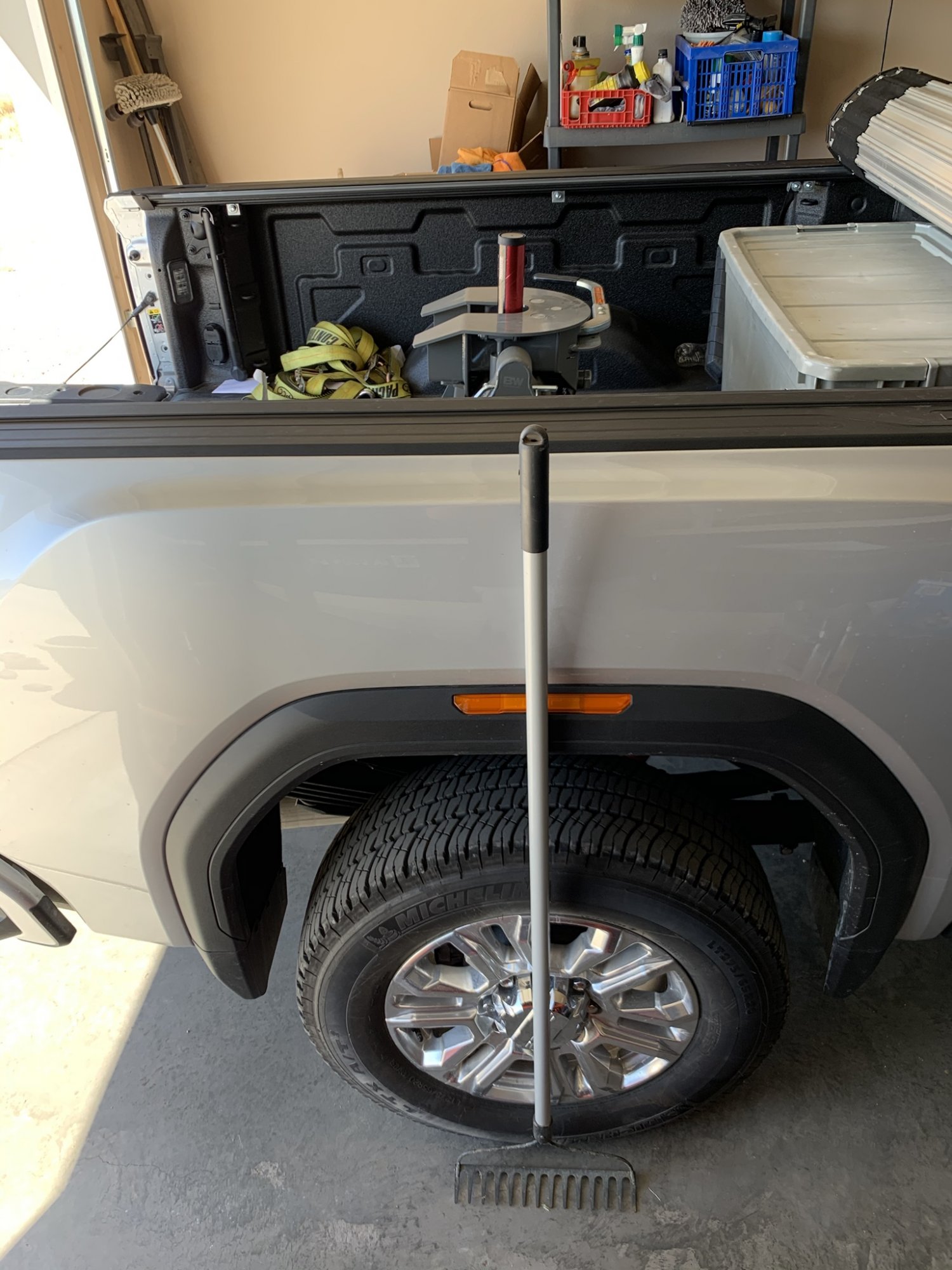

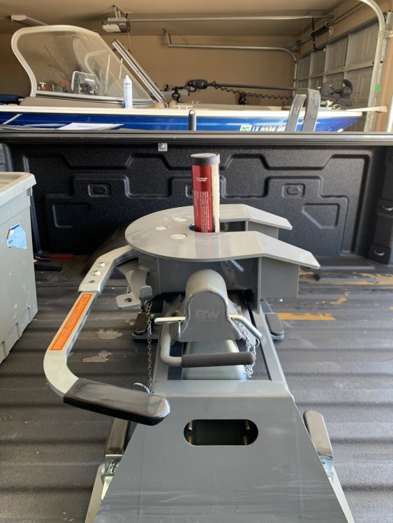

Im not necessarily concerned with where the pucks are in relation to the gooseneck, im concerned where the hitch is in relation to the axle.  In the straight up position at least on the B&W companion RVK3710 model, the hitch point is slightly rear of the axle.  Attached photos to sorta show, its very minimal probably less than 1.5 inches.
