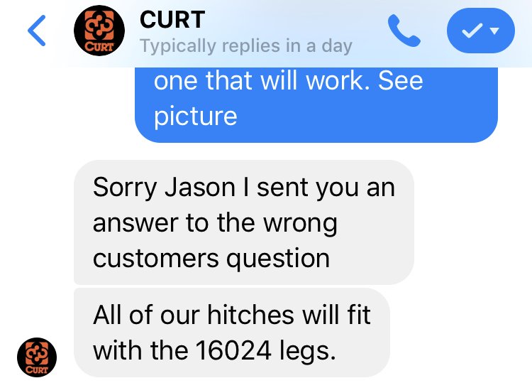

So, I heard back from Curt and B&W. Curt says they have new legs #16024 that fit any fifth wheel hitch and now fit the 2020 gm/chev pucks. B&W companion says they have the RVK3775 that will be out mid September
