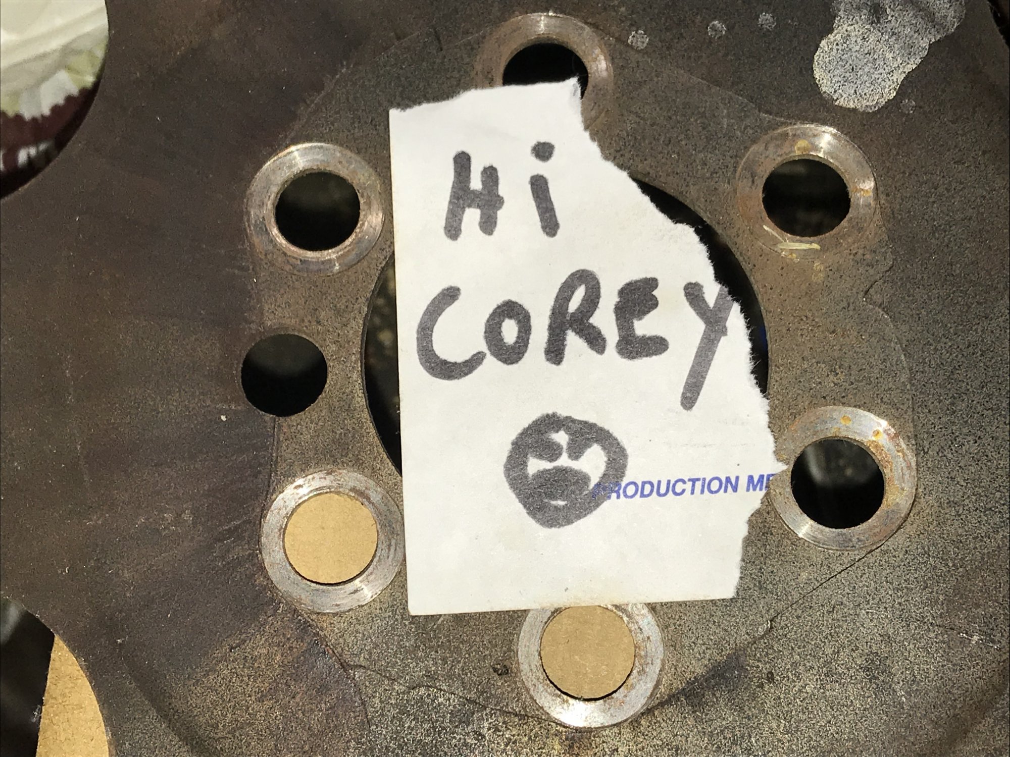

I had the motor out at 120K for an oil pan leak and found the flex plate shattered in the center form doing the above (Most likely) and the trans never gave me one bit of trouble.
I even kept that one as a souvenir.
