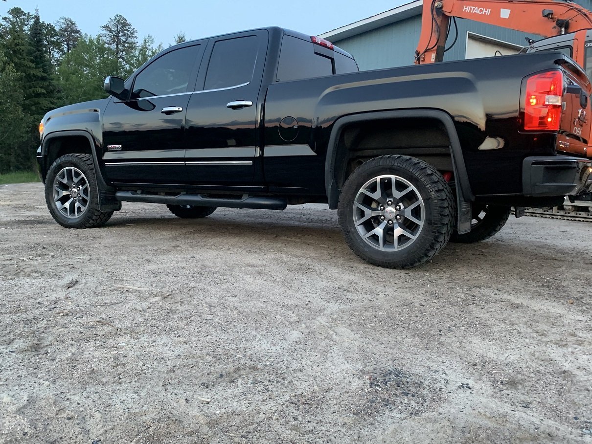

https://www.1010tires.com/Tires/33x12-50R20 I run that size, you know what I do with that truck in the winter? Park it. You wont move anywhere in 2wd with a 12.5" section width. It displaces too much of the trucks weight. If there was 3" of snow on the ground, I would be unable to accelerate passed 30mph in 2wd. They are amazing on dry pavement though. I am running Pro Comp AT's and hate them, they throw huge rocks and have piss poor traction in any situation beside dry pavement. Honestly I would recommend a 285 or 295 max, my friends 305's are even a bit wide. Here is my truck wit 12.5's. You're going to have a bad time with that size in the winter. I get 15mpg in the fall with my 6.2L I would expect 12mpg mid winter, even worse than that if you have a 5.3L
