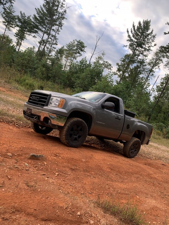

New to this forum, I have a 2008 GMC Sierra 1500 and I’m trying to beef her up a bit. I bought it already with a leveling kit installed and now it’s time to get it up higher.. my previous vehicles were all jeeps so I’m semi new to the whole off roading with a truck scene. What’s the best way to get 4.5-6 in of suspension lift ? Body lift ? What parts would I absolutely need to swap out for a lift of this size? I have 32in MTs on here already,  but looking into getting a 35s’ after the holidays . Thanks for your advice and time!
