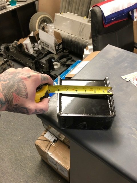

What do the rear blocks measure with these kits?
I'm going to run mine at 9" and I ordered the add a leafs but I'm afraid it's going be saggy in ass end. I looked at all the 9" McGaughys trucks w/37's on Custom Offsets gallery and some of them are saggy with the add a leaf. Some are dead level. No add a leaf set at 9" real saggy. I don't do saggy I'm old. I was hoping to have a little rake maybe 1" at the most. I still need to tow a 3500 lbs enclosed cargo trailer. Or a boat that weighs around 2900. I'm wondering if I should get the 6" block. That's a lot of block though .
I’m not sure what size rear blocks they are I can measure them when I go back to my shop tomorrow I’m not gonna use them anyway. I don’t do saggy either. You could always use helper bags or just get taller arched leafs like me. But if you got a six-inch blocks you’re definitely going to want to run traction bars.
7 minutes ago, CovetedStyle said:
I’m not sure what size rear blocks they are I can measure them when I go back to my shop tomorrow.
I'd appreciate it if you can measure them.
That's a for sure on the traction bars. I think you need them anyway.

It’s a 6 inch block my friend A3B165C3-BC49-481F-945F-02DFF0ABDB63.jpeg.be252a5b3e9e9fb9b170bacbb2aed1bb.jpeg
Thanks for your help
