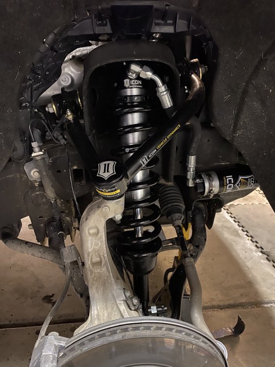

Anyone Install Icon Stage 1 in 1500 3.0 Duramax?
I want to lift the truck a little for the plow I installed.  I'm thinking of doing the Icon stage 1 kit.  Icon can't verify compatibility w/ the 2020 MY yet.  Has anyone installed the Icon kit on a new 1500 diesel?  Icon tells me the Eibachs they use on the 2.5 VS shocks are 650#.

Well said man, and very nice set up. I’m doing the same kit on my trail boss
I have the icon stage 1 on my custom, stage one I ran into a problem turned to 3 inches. The stage one had an aluminum internal spacer that limits travel. The ride was harsh, they said send em back and they will remove the spacer.. so I did a moto fab 1/2 inch lift to get it off the spacer and the rides better so it worked.  Seems good now, no harsh bumps on or offroad.
I did the stage one without control arms, on sale 1300.00..   I bought rc control arms instead of theirs.

Polyperformance black friday sale, came with rear shocks but I hate to say i wasnt impressed and removed them for a pair of bilsteins..    it's a 2019.
