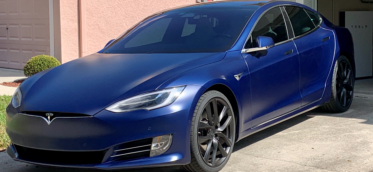

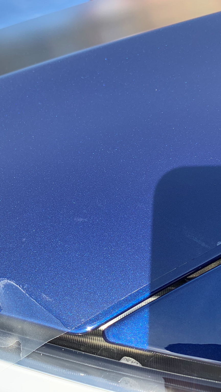

Full-Vehicle XPEL Stealth w/ Gtechniq Crystal Serum Ultra:
What I do have experience with is XPEL Stealth (full-vehicle Paint Protection Film-PPF) with Gtechniq Crystal Serum Ultra added on my 2018 Tesla Model S. I find both product very attractive and useful for protecting the vehicle. One thing to remember is if you go with a clear full-vehicle PPF you will want to do a paint correction / restoration prior to the PPF to get any defects out of your clearcoat (even on a brand new vehicle).  Some places charge $1800 just for a paint correction alone.  What I like about the XPEL Stealth (PPF with a matte / smooth satin finish) is that you don't need to do a paint correction since the matte finish hides the majority of the defects AND you still get to see the metallic flake underneath, if you have it in your paint.
I have attached pictures to show you the difference between the original color of the vehicle and the stealth film. The full vehicle picture shows the complete product. I think doing this to a would look awesome.

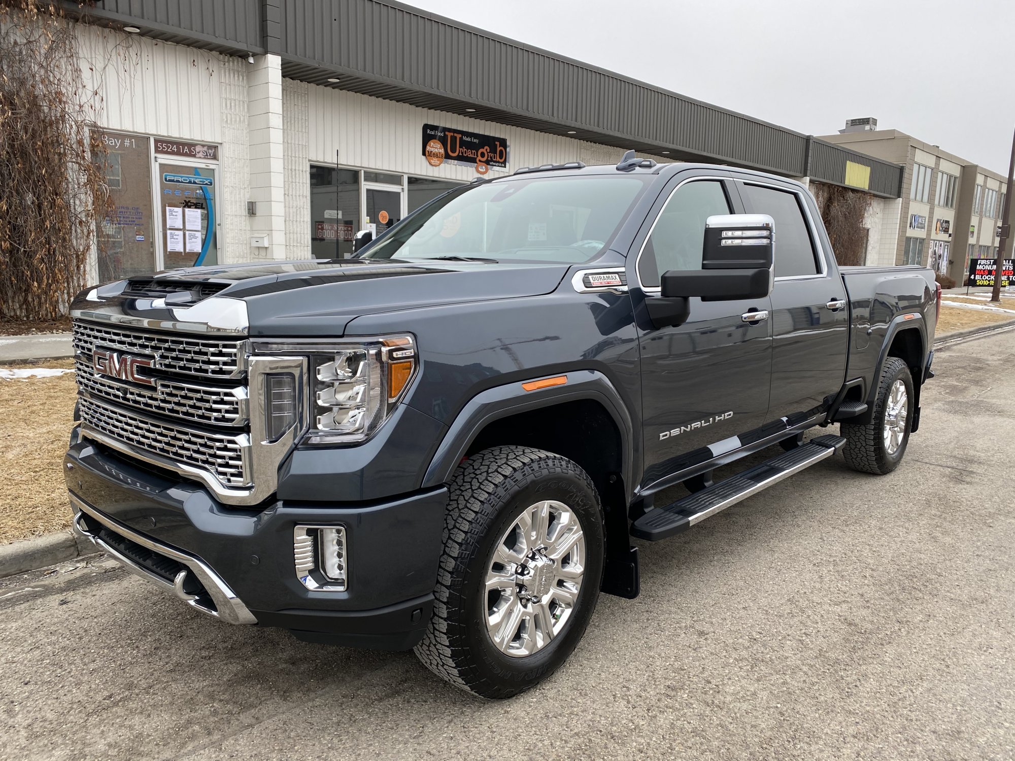

On my 2020 3500 Denali HD I have had the full Xpel Ultimate plus and the full XPel Fusion Plus Ceramic coating for about a month now and can make the following comments:
  • The finish is definitely glossy and shiny (see picture below).  I think it comes down to personal preference.  I do like the matt coating on the car above, but I think my personal preference on the truck, given it is such a large palette, would be the gloss finish.  But again, this is definitely personal preference.
  • I was surprised that I still get the dirt film on the vehicle when it gets wet and dirty.  For some reason, I expected that to be less prominent.  Even after a good pressure wash, the dirt film is still there and requires hand washing.
  • They were not able to complete the rocker panels.  They said they tried all the tricks, but just could not make it stick.
  • I love hand washing the truck with both coatings on - it's nice to not have to worry about making swirl marks, and if I do, they should be easy to remove with the self healing properties.
  • They did the ceramic coating on all the external black plastic parts of the truck.  I find that some of them still seem to dull, and some seem as shiny as new.  I am reaching out to them to check to see if we can re-coat some of the parts that seem to be be faded.
  • I picked up my truck from the dealer and drove it right to the detailers.  I told the dealer not to touch the outside of the truck at all, but there were still a couple of corrections to due.  However, the detailer did not charge me extra for the corrections.
  • I bought a gallon of the XPel rinse free wash (https://www.xpel.com/Flawless-Finish-Rinse-Free-Car-Wash-16-oz) as up in Calgary here, it is a bylaw violation to bucket wash your vehicle outside.  It is highly concentrated and should last me a long time.  I give the truck a really good pressure wash with just water, and then use the XPel product - works very well.
  • This was an expensive endeavour ($5000+ here in Canada)...but I would definitely do it again.  Cleaning is way easier and the "no swirl marks" relieves some of my OCD anxiety ?  Plus, it looks amazing when it is clean.
