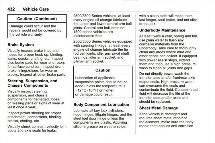

I just crawled under my 2020 and did my first  LOF at 4900 mi
All I  found 8 fittings
they were all  bone dry
Is there a drain for the fuel seperator
18 hours ago, Dave mags said:
Sorry if I didn't reply correctly 1st timer here !!!!
If you found 8, you are missing one.  Should be 9.
  • (2) outer tie rod ends
  • (2) upper ball joints
  • (2) lower ball joints
  • (1) top of pitman arm at the center link side of the arm
  • (1) top of idler arm pivot bracket
  • (1) top of idler arm at the center link side of the arm
The fuel filter has a drain.  The center of the filter cap opens up.  The Duramax supplement manual shows it in there.  Its under the "Water in fuel" section.

never would of found the 9th grease if it wasn't for this thread. took front skid plate off to reach . Thanks

I changed oil on my 20 GMC at 2 months old and every grease fitting took minimum of 8 pumps from my pneumatic grease gun.   Dry as a bone from the factory (built 1/20)

I just got done rotating tires, changing oil and greasing .i would say yes on removal of skid plate. Only four 15mm bolts . The 3 fittings on idler arms aren’t easy either. The dealer or quick change shop would never get to them

I took a peak at mine after washing it today, could see 6 fittings without crawling under it.  Will see if I can get the truck under the garage door tomorrow and crawl under it. Not sure I am gonna clear, think my door height is 7'2", by just eyeballing it, appears it is gonna be close.
Would be curious why these are coming from the factory dry, or with minimal grease.  Is it a qc issue?  Took 6-8 pumps in all the fittings.  And yes the plastic skid plate is not an issue.  My truck was built on 8/20.
Was able to reach all of them with a standard pistol grip manual pump gun with a 12 inch hose.  I can see where a 36 inch would make the job much easier.
After reading these posts i crawled under my 2020 2500 HD. All nine grease points were pretty much dry. I was able to grease them all without removing the skid plate, using a grease gun with a one foot rubber hose, and straight coupler. My arms were covered in undercoating, trying to reach the zerks. I will grease it next time with a 90 degree coupler. I believe that will work much better.
I greased mine this morning and there was not enough clearance to get my fitting on it for both bottom ball joints. It is a lumax quick release so maybe the side wall is larger than a standard fitting. I’ll have to swap it and give another try.
No issues getting the the rest.
