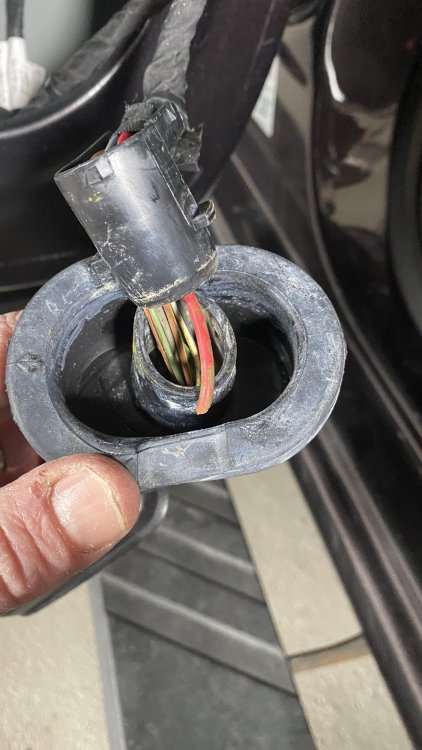

Well I found my problem. It was a broken red wire which is power to the rear door switch. I found the wire in the rear door wiring harness.  There were 2 other wires in question with either nicks in the insulation or possible break.  I cut and spliced these as well just in case.  The red wire was corroded too and broken clean in half with plenty of slack to do the repair.  I also had an issue with the connector to the rear door switch.  I ended up removing all the pins and "refreshing" them by pressing gently to tighten up where thay make contact to the actual switch connection.  As of now all is well.
