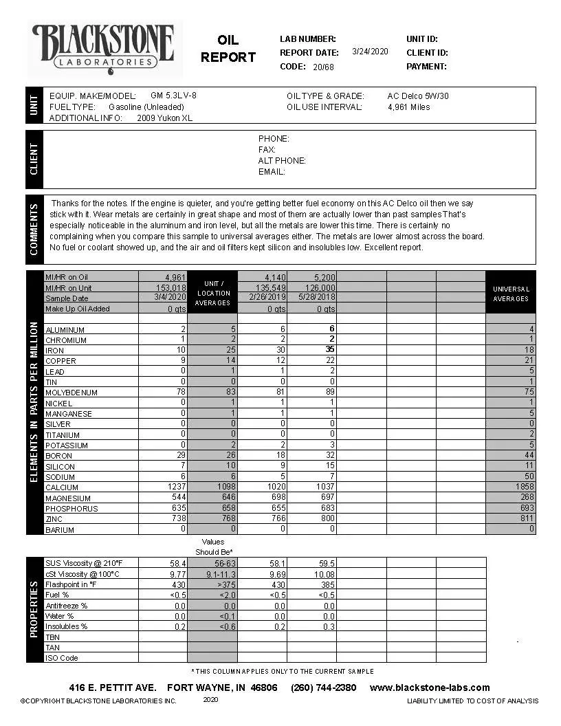

My latest Blackstone Labs report.  This is 2nd run of new ACDelco oil, the other two samples are plain old Mobil One.
