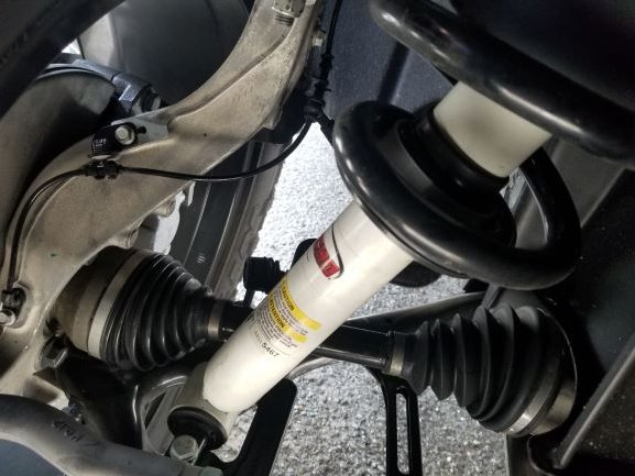

On 5/3/2020 at 10:25 AM, Silverado4x4 said:
So now you have a 4.5 leveling kit? Man I would love to see pictures of the CV axle angles. I bet there not going to last long.
I would agree the CV axle angles are not ideal however, all work was performed by the Chevrolet dealer. Its something I'm going to watch very closely and if i start experiencing issues you can rest assured they will be making repairs at no cost to me...
eeek....thats a bit cringe worthy, or at least the angle of the photo makes it. Good call on the dealer install aspect.
Yeah I don't like that angle at all, worse when you go to full lock on the steering for the lower boot. The failure will be the boot at the front diff. how its pretty much fully extended at the top. But yes keep an eye out on them if they start slinging grease there done or if you feel or hear a popping noise when making a sharp turn.
