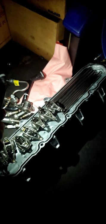

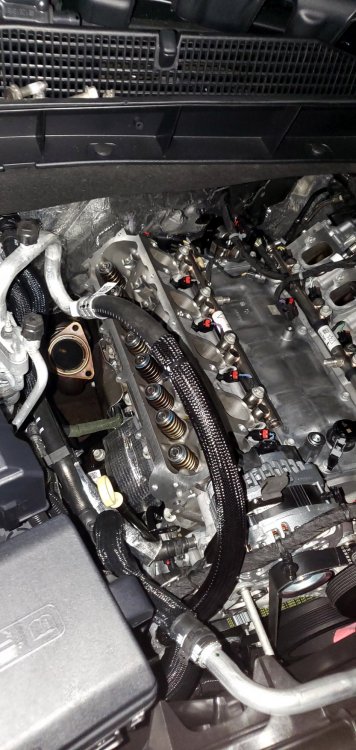

It went from idling normally while I unloaded the bed at the dump to suddenly stumbling and ultimately stalling.  If I held the accelerator down and cranked I could get it to start.  As long as I kept my foot down and the rpms around 2k it would run but it was shaking bad and that's when the check engine light started flashing.  Let my foot off... Stall.
Had my daughter bring some isoheet just in case it was water in the fuel.  Shook the truck to mix then restarted with same results.
After the tow same thing.
Got a call from the dealership.  Broken valve spring.  Awaiting words.
