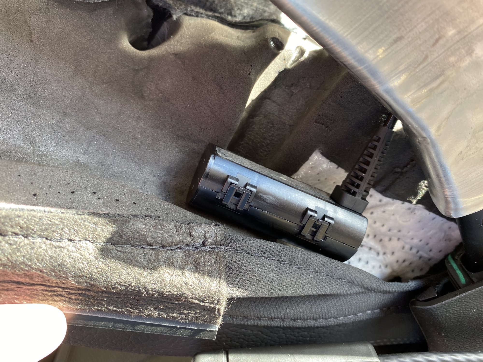

On 2/20/2021 at 9:13 PM, Lawnboy01 said:
I took out the vibrators. Zip tied them up under the seat. Big improvement
Did the same. I used double sided tape to mount the sensor motors to the bottom of the seat pan thinking maybe the vibrations would be felt. Nope! So I turned them off.

Unless they redesigned the seat bottoms on the ‘21 they are not buried at all. I believe they sit in a recess and the only padding is the upholstery. When I removed mine, I pulled them out through a small hole in bottom of the seat foam. The hole is for the wire and connector to pass through but large enough to remove the sensor motor. I made up two plugs from some closed cell foam and inserted them into the voids.
That’s a great idea. My next mod. I just need to find something to fill the void. Was thinking spray foam and tape over the hole to keep it in till it sets.
I cant feel the empty spot
