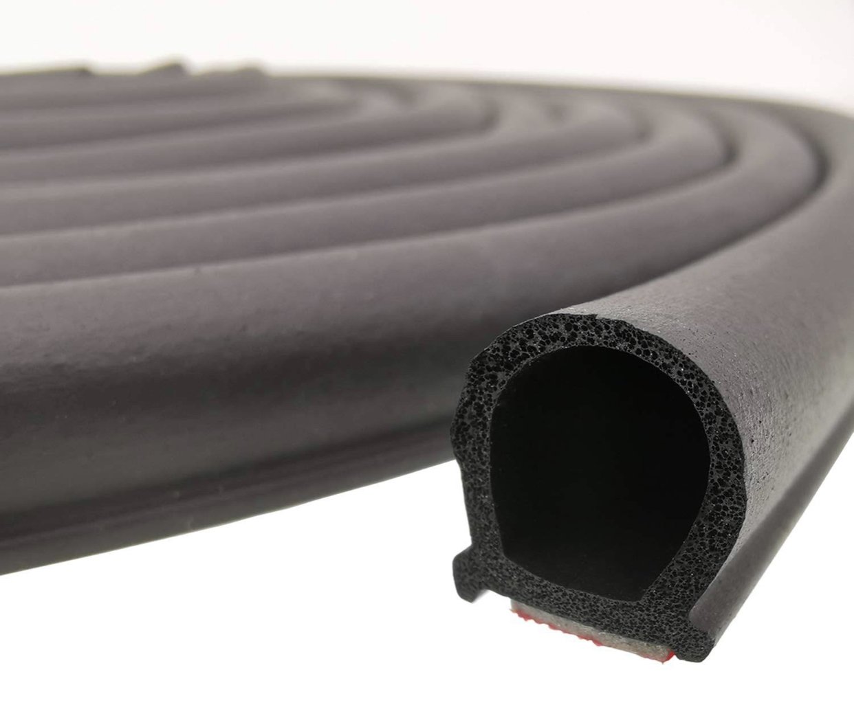

Thanks for all the reply ideas. I took a chance on this, w/o being able to see it in person. Couldn't have custom made it any better. Cut to length and notch out to fit under bed rail protector. Just reaches to the glass. Looks like with the carbon bed and rear glass the same heighth, this truck won't have rubbed paint.

Well this is it. I paid $18.57 in January of '21. I guess inflation?
https://smile.amazon.com/gp/aw/d/B005IUDC16?psc=1&ref=ppx_pop_mob_b_asin_title
