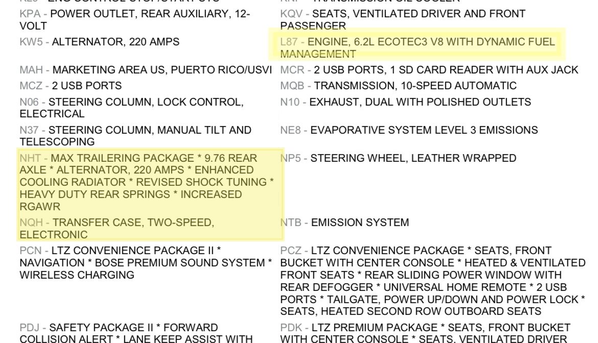

sldhead700 Posted March 1, 2021 Posted March 1, 2021 2 speed is standard on all 6.2s as well. Between that and the Z71 trucks, I would bet at least half of the 4x4s on the lots still have 4L.Is the 2 speed still standard on a max tow package if you get the 6.2?I thought I had read the 2 speed wasn't available on the max tow package at all, but they didn't say anything about engine options making a difference?Just wondering if it makes a difference which engine with that package?I haven't traded my 2017 yet partially because of this.I currently run the 6.2 with the max tow, And while I don't use 4 low very often, there are a few times that I have wanted it for the heavy load on soft grounds. I don't even know why they would take the two speed away from the max tow package even in the smaller engines, makes no sense to me.If anything you would think you take 4 low away from the street versions trucks, that never pull anything or go off-roadSent from my Pixel 4 XL using Tapatalk

AlaskaErik Posted March 1, 2021 Posted March 1, 2021 43 minutes ago, sldhead700 said: Is the 2 speed still standard on a max tow package if you get the 6.2? I thought I had read the 2 speed wasn't available on the max tow package at all, but they didn't say anything about engine options making a difference? Just wondering if it makes a difference which engine with that package? I haven't traded my 2017 yet partially because of this. I currently run the 6.2 with the max tow, And while I don't use 4 low very often, there are a few times that I have wanted it for the heavy load on soft grounds. I don't even know why they would take the two speed away from the max tow package even in the smaller engines, makes no sense to me. If anything you would think you take 4 low away from the street versions trucks, that never pull anything or go off-road Sent from my Pixel 4 XL using Tapatalk My 2019 with the 6.2 and max tow has 4LO. 1
OnTheReel Posted March 1, 2021 Posted March 1, 2021 (edited) 45 minutes ago, sldhead700 said: Is the 2 speed still standard on a max tow package if you get the 6.2? I thought I had read the 2 speed wasn't available on the max tow package at all, but they didn't say anything about engine options making a difference? Just wondering if it makes a difference which engine with that package? Yeah, I have max tow and the two speed. The only way to get that combo is with the 6.2, the 5.3 max tow stupidly comes with a single speed transfer case. They don’t really advertise it as such, but the two speed transfer case is tied to the 6.2 automatically no matter what suspension package. Edited March 1, 2021 by OnTheReel 1
sldhead700 Posted March 1, 2021 Posted March 1, 2021 My 2019 with the 6.2 and max tow has 4LO.Great to know!Thanks!Sent from my Pixel 4 XL using Tapatalk
sldhead700 Posted March 1, 2021 Posted March 1, 2021 Yeah, I have max tow and the two speed. The only way to get that combo is with the 6.2, the 5.3 max tow stupidly comes with a single speed transfer case. They don’t really advertise it as such, but the two speed transfer case is tied to the 6.2 automatically no matter what suspension package.Thanks!Great news with that information!Sent from my Pixel 4 XL using Tapatalk

ember1205 Posted March 1, 2021 Author Posted March 1, 2021 Not sure if you're all commenting in regards to the 2021 model year or not, but the brochure definitely makes this difficult to follow. The way the brochure is written, it seems to say (when you first read it) that the two TB trims and the HC trim don't include the two speed transfer case, but that's because it's baked into the base trim. Really stupid way of writing up the various features for the packages and trims. It -appears- that the Max Tow package has no relationship to the availability of getting 4L.
Z45 Posted March 1, 2021 Posted March 1, 2021 (edited) NQH Transfer case, two-speed, electronic Autotrac with push button control (4WD models only) 1 - Included and only available with (X31) X31 Off-Road Package or available as a free flow option on TK10903. 2 - Included and only available with (X31) X31 Off-Road Package. 3 - Included and only available with (L87) 6.2L EcoTec3 V8 engine or (X31) X31 Off-Road Package. NOTE Standard on AT4, Denali. Custom Trail Boss, LT Trail Boss, High Country Edited March 1, 2021 by elcamino 1
OnTheReel Posted March 1, 2021 Posted March 1, 2021 1 hour ago, ember1205 said: It -appears- that the Max Tow package has no relationship to the availability of getting 4L. Depends. Ordering max tow excludes you from getting the Z71/X31 off road package. So on 5.3 trucks it is completely impossible to get max tow with the two speed because it would only come via the Z71/X31 package. While the two speed is also standard on factory lifted trucks, Denali, and 5.3 High Country, those trucks cannot get the max trailering package. The 6.2 High Country oddly enough can, but that’s another story... 1
