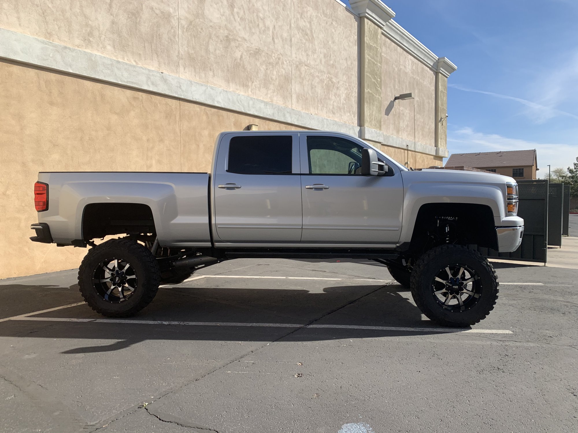

Honestly, the 2 inch leveling kit would have worked fine with your stock tires...  Even with a 3" leveling kit and a 1" rear block, you will still rub with your current tire size.  I installed a 3" leveling kit on my buddy's 2015 Silverado and he runs 20" wheels on 33's and he still rubs.   My thoughts are you need at least 4.5" suspension lift to clear your tires.  It sucks cause it'll cost you more than a 2" leveling kit....  If all fails, go big... like 15" lift...ha ha ha!  Good luck!
