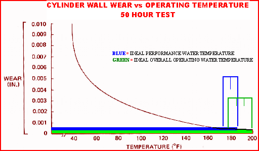

From the same source:
There is a range where both optimum performance as well as minimal wear share similar characteristics. That number lies in the 175-180 degree range as shown by the overlap in the chart which correspondingly requires a 180 degree thermostat. FWIW, higher operating temperatures of today's engines are to fight combustion by-products and pollution.
Porsche puts maximum engine life oil temperatures (bulk) between 180 - 210 F.
So where are we. Water temperatures between 175 and 180 F will give pooling temperatures of 205 F and 250 F or on the path of lowest oxidation, sludge and varnish production.
Problem is GM is running 207 F thermostats that hold closer to 212 F leaving pooling temperatures over 248 F shortening oil and motor life. I'll give GM this. Actual pooling temps in the Ecotec3 is a bit lower due to cold side oil cooler/heater arrangements.
