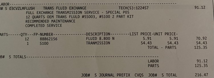

Just had mine done at the dealer.
Flush and fill with a filter change.
Not a big deal.
Not a big deal.

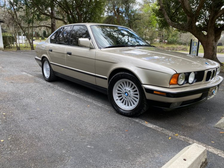

On my BMW 1990 535i, I do a lot of my own work like ECM and TCM chips, wipers, stereo (with the stock radio, gotta keep it original) etc., but, when it comes to the important stuff, i.e. engine, transmission, power steering, I still take it to my local BMW mechanic who specializes on old BMWs (heck, he adjusted my valves a second time for free because the first time wasn't perfect - 200K and still going).
BMW:
