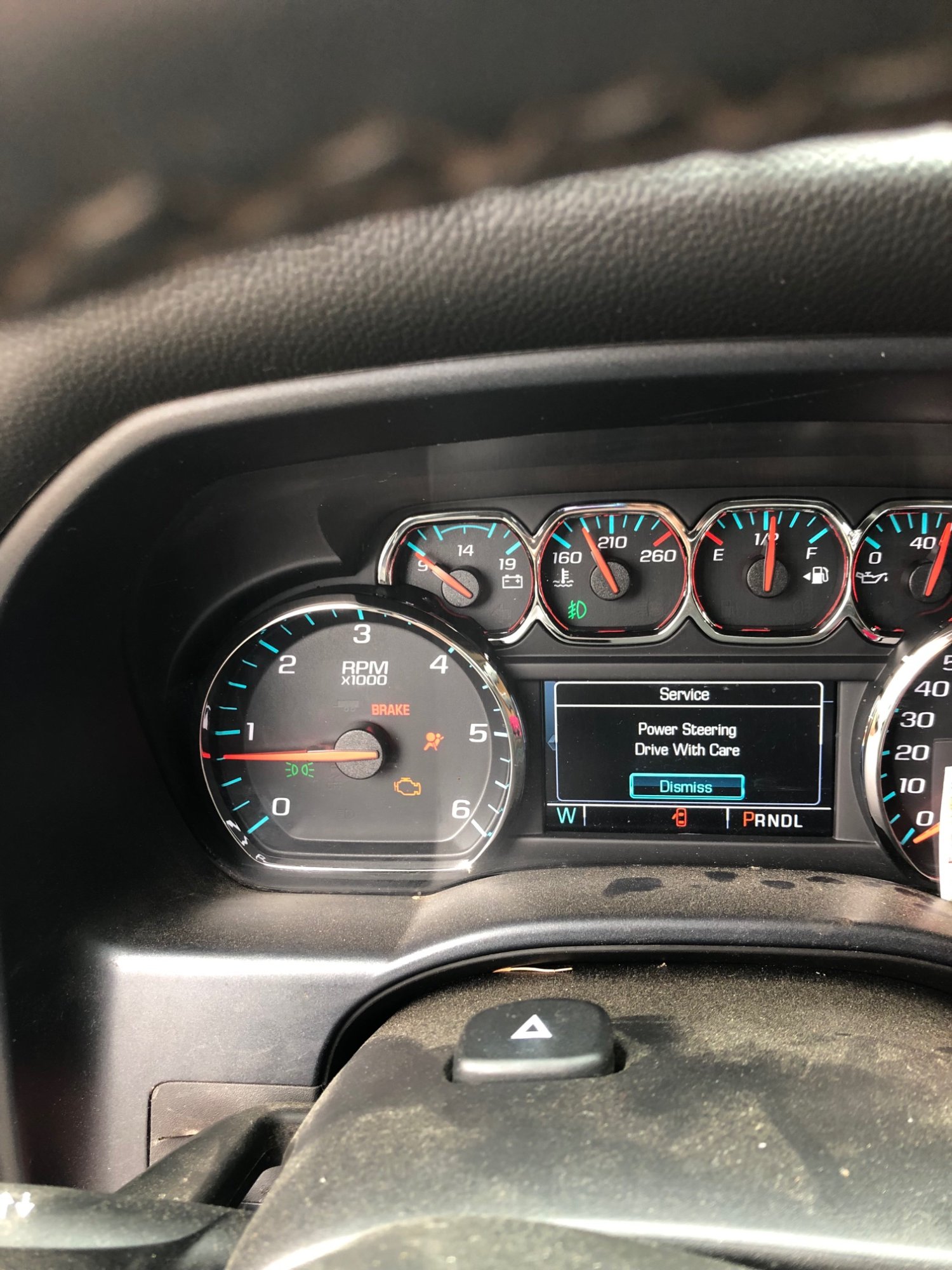

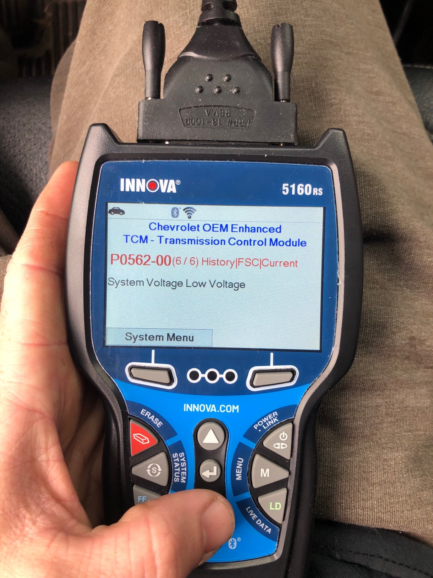

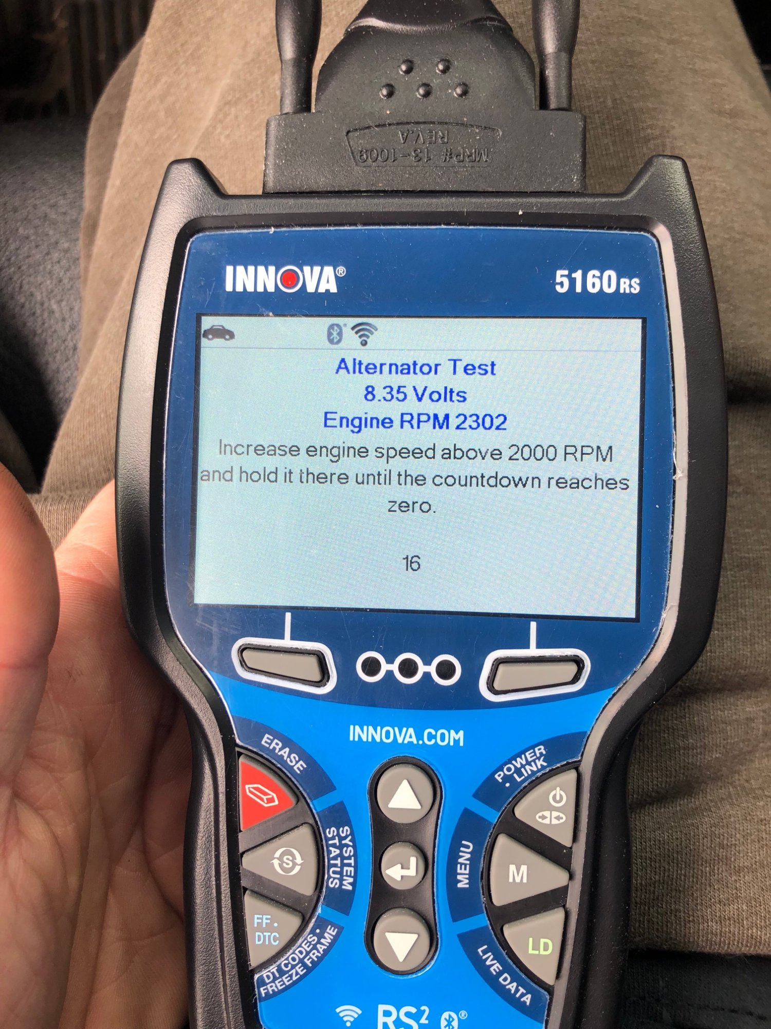

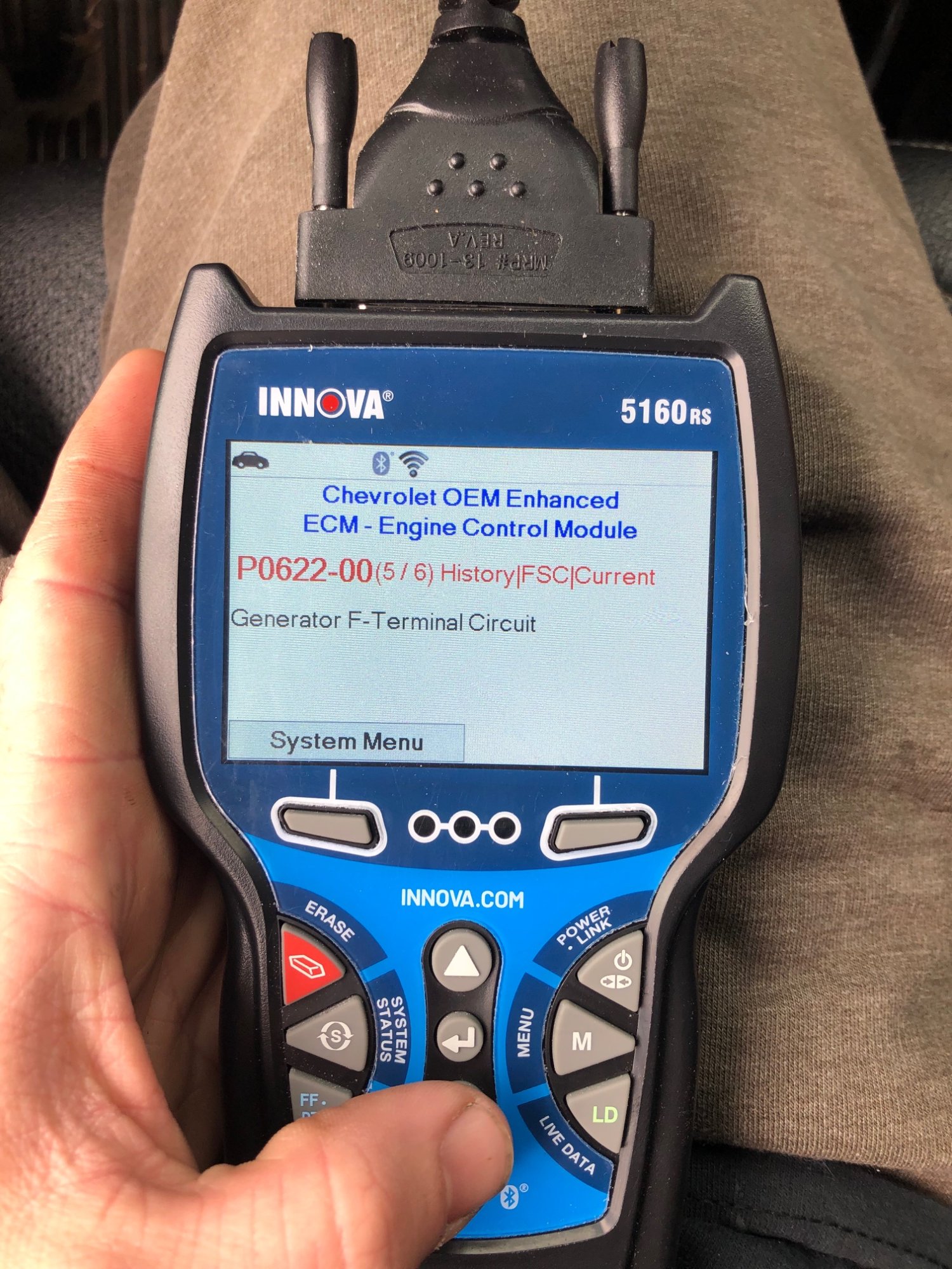

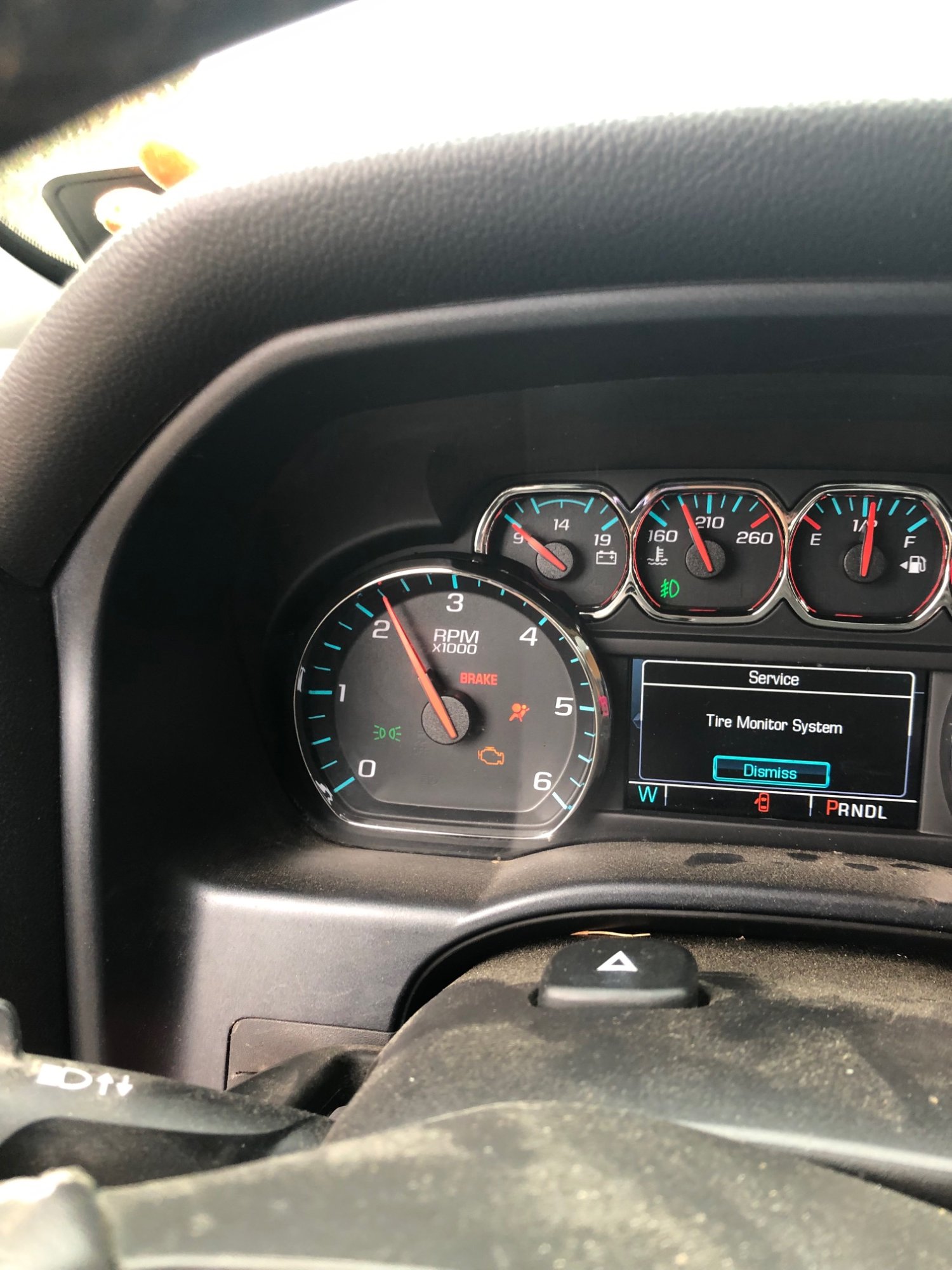

So I’ve changed just about everything including another new battery and alternator and cleaned all grounds then tried to run diagnostics test and can’t figure it out. Can anyone thing of anything else?976B23CA-DDA9-48F6-964C-39AC54B95A7A.thumb.jpeg.778a872cac23cd15818902fbd80304b0.jpegEB05A301-E9CC-4BA0-9F91-892D21CF2A39.thumb.jpeg.56b4bb8d5be07e3092cd848b89392741.jpeg488406B7-7F44-4738-A1D4-F98113864098.thumb.jpeg.27485ffa8a114be457e2cdb8e9812345.jpeg858CB93F-BCEB-4C8B-B197-8975D207D2B9.thumb.jpeg.a420ea79b9ff1abc4b4a1a70509ab517.jpeg6B62CC73-235D-49EC-9538-2C29FD5C5518.thumb.jpeg.9a919f4a2daaf74e1f005ed4cf0bcbc3.jpeg267E94FB-2A5F-41D9-8BEA-9C6F443AFBC5.thumb.jpeg.a133da8e7f87ee4c02c23a0d2148b640.jpeg

When increasing the rpm over 2500RPM is the alternator charging (tested directly with a voltmeter on the B+ terminal of the alternator)?
What voltage do you read on that terminal?
What voltage do you read if you measure the B+ terminal against the alternator case?
What voltage do you read if you measure the B+ terminal against Battery - ?
After that, I'd check the "D+" terminal. As this is probably a PWM signal, you should check that with an oscilloscope.
I'd double check ALL the fuses, maybe on died because of the old alternator.
You mentioned that you checked the wiring. How did you check it? Did you measure loss of voltage in idle and under load? A circuit that is fine under idle, can die under load.
