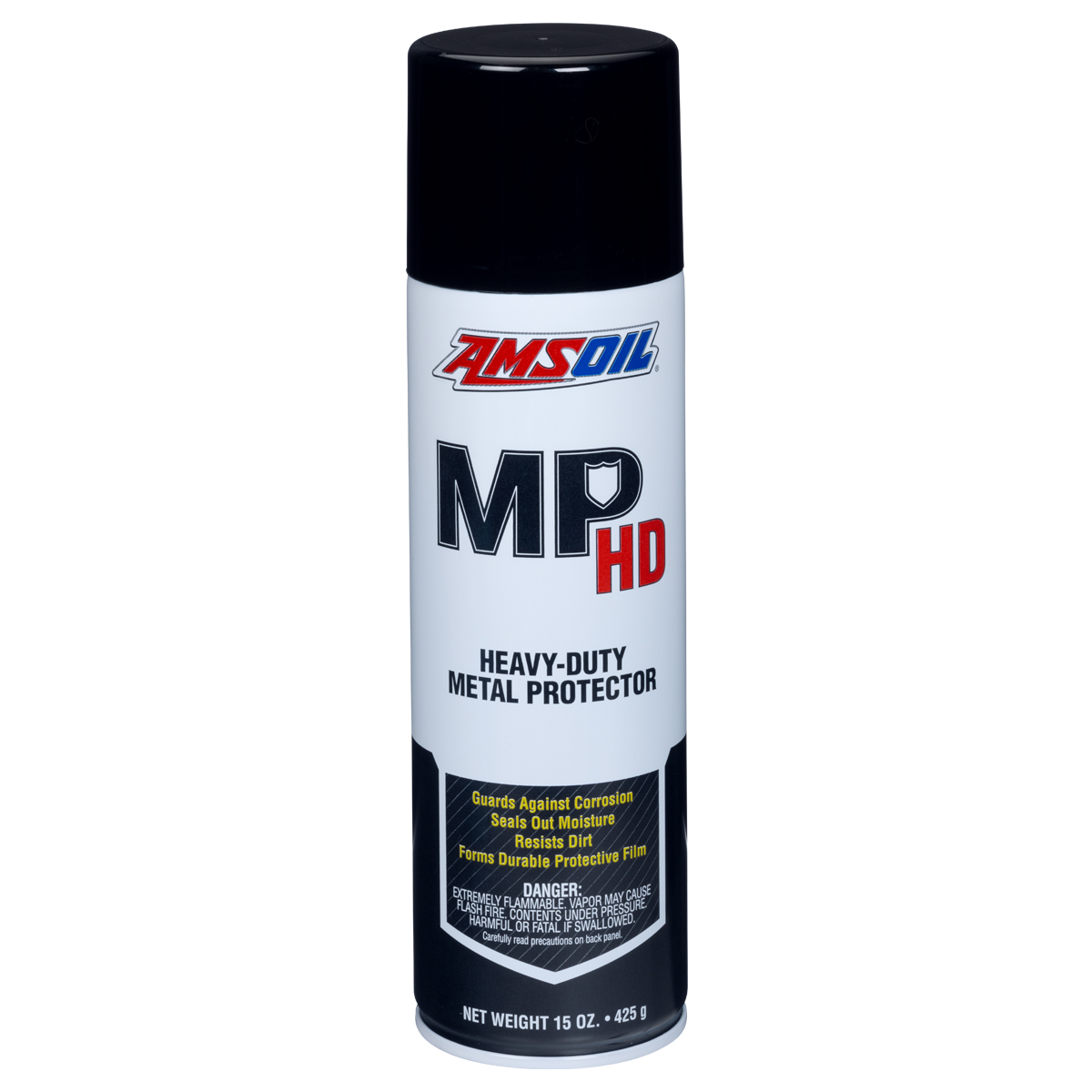

AMSOIL's Heavy Duty Metal Protector works great for an undercoating or even touch ups.  I use it on my 2019 Silverado. It doesn't effect the factory coating.  If you want a quote for a couple cans let me know.
https://www.amsoil.com/p/amsoil-heavy-duty-metal-protector-amhsc/?zo=521390
