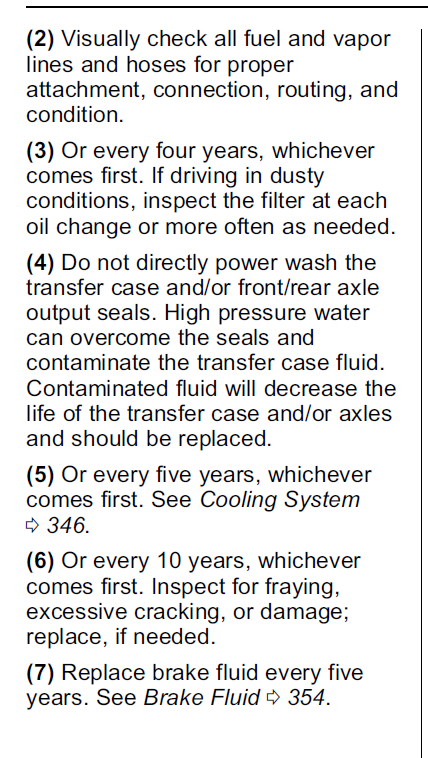

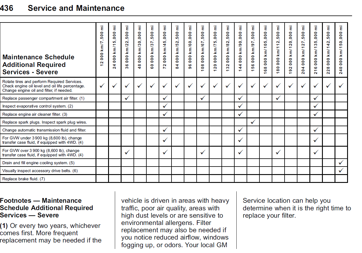

Get out that service manual and find the "Severe Service Schedule". The list in a Haynes Manual is a bit more exhaustive.
The key to your wish quoted is inspection and testing. The list help you capture everything your memory will forget. 😉
If you lost or didn't get the manual, a free pdf can be downloaded from GMC or Chevy sites.
This is from 2018 manual, but 2019 will be similar/same.
  • Thanks 1
