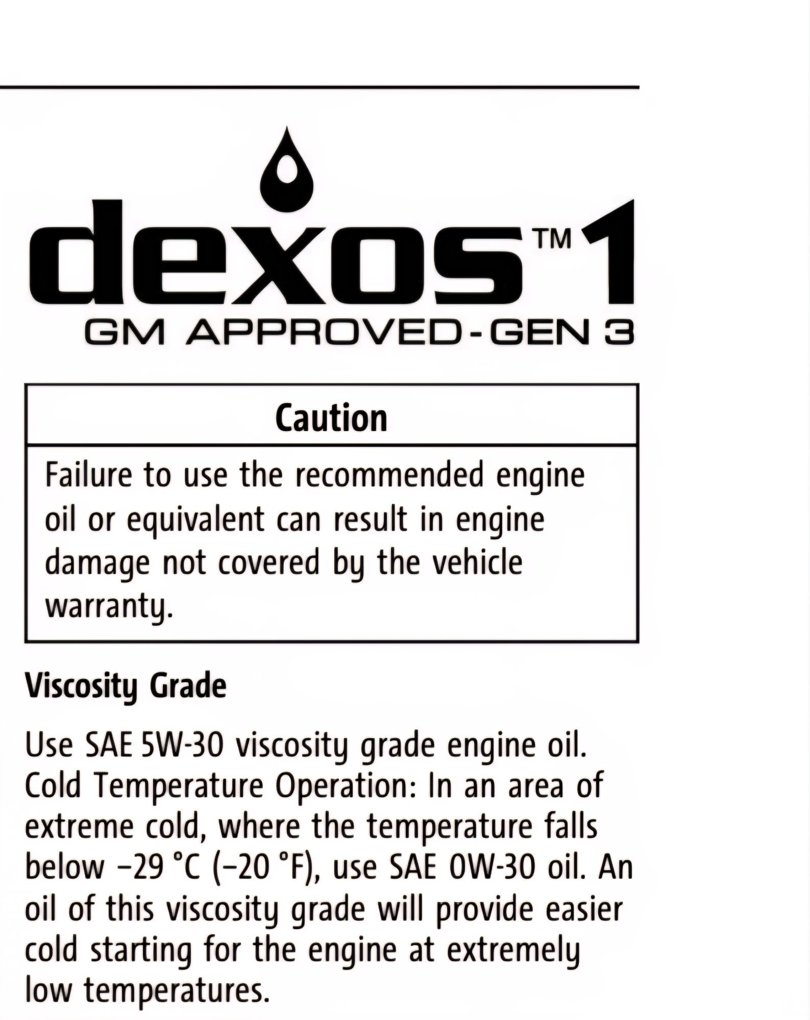

Looking @ my manual, I saw this:
Screenshot_20250925_094440_SamsungNotes.thumb.jpg.687ec8f6be79f1850ab215e087264cb4.jpg
I dont recall seeing this concerning past trucks. It may have been in the manuals, but I ignored it since it didnt apply to me.
I wonder if this recommendation is more for trucks that aren't able to utilize a block heater which comes on @ -18* C/ 0* F?
Edited by revrnd
My '12 3500 has that same recommendation in the owners manual (different wording), my '04 3500 says to use either 5w30 synthetic or 0w30 below -20f/-29c
  • Thanks 1
that bother me that 0w40 is not recommended , Im maybe not rational but I like how this oil fit the winter and the hot summer month especially for a working truck
