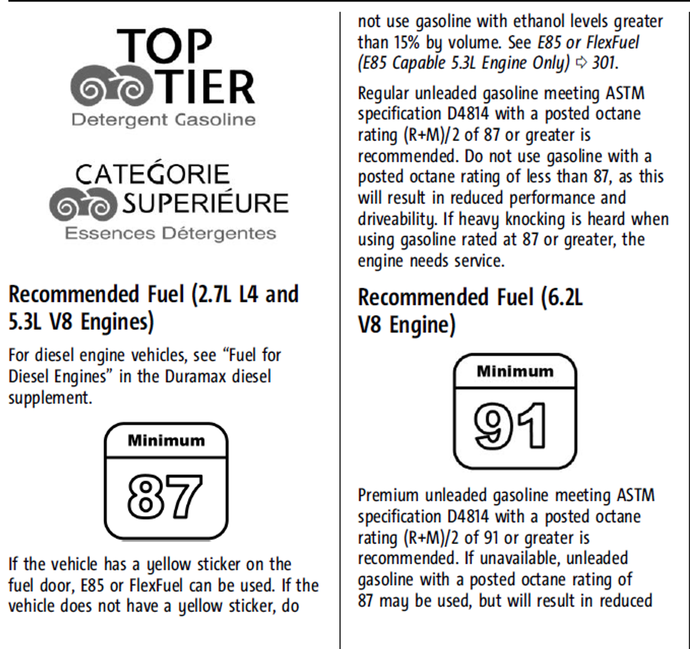

23 hours ago, ember1205 said:
Nope. This is from the 2024 manual, but same Turbomax engine.
Good to know, thanks
