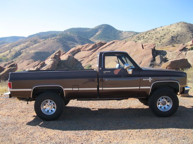

The only reason that dam is on there is for aerodynamics/better gas mileage. Less wind resistance on the underside of the truck. Check out the lack of a chin spoiler on my old 83 K20. Never once got hot.
