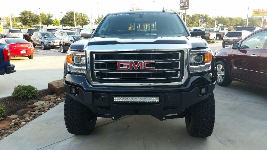

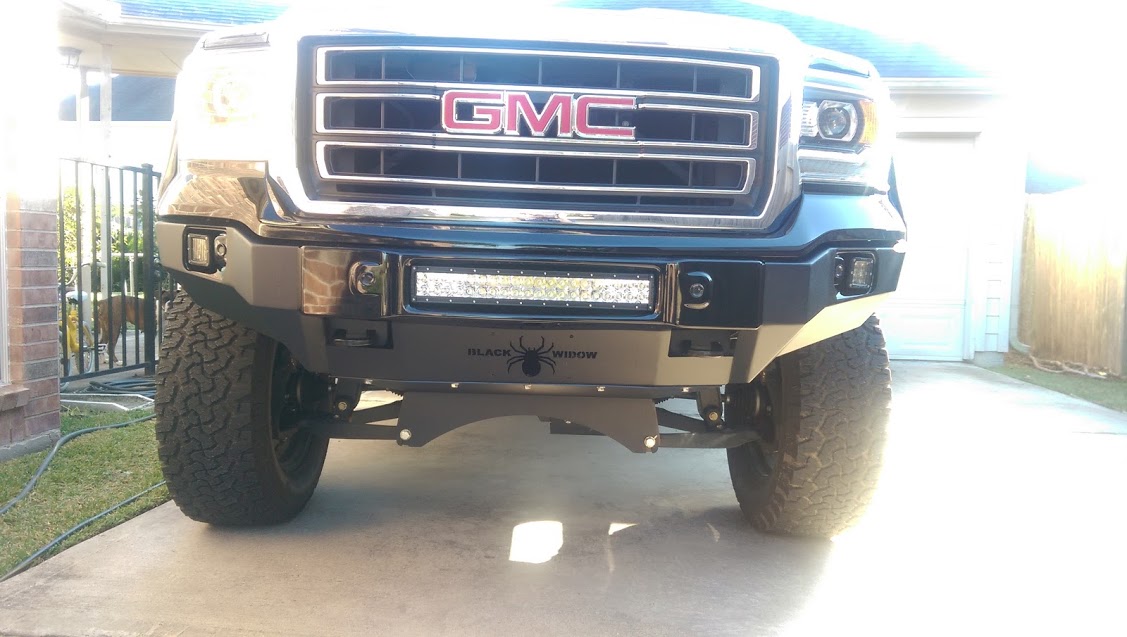

What's the story on their bumper? I've tried until blue in the face to contact SCA and no luck. I love that bumper look but I want to fit it with a light bar and a 10-12k winch with synthetic rope. and chance for some pictures of the winch mounting location and some measurements?
Have you tried contacting SCA through Facebook? Everything they post on Twitter links you to
Facebook and I don't use Facebook. SCA has never responded to my emails or tweets.
My truck was purchased with the bumper and lights, just as you see it, from the GMC dealer. I haven't had to contact SCA Performance. I did see on their website that the newer bumper does have a winch mount and the Rigid light bar has a grill built into the bumper for additional light bar protection.
right, I've gone to Facebook and messaged them directly can see where they read the message, but chose not to respond I guess...
