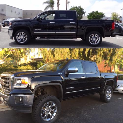

Before and after of 6" BDS lift with Toyo RT 35x12.50r20 tires with stock 20x9 wheels. I used the block lift option in the rear with no leafs or spacers. There is no rubbing or trimming required. I also replaced the stock chrome side step with the AMP power steps. I'll post more pictures when I take it out for some light break in off road! There is a slight rake to the truck (rear is an inch lower than the front when measuring center of wheel to fender. I might do an add a leaf to make it level; especially since I tow.
Love it!
