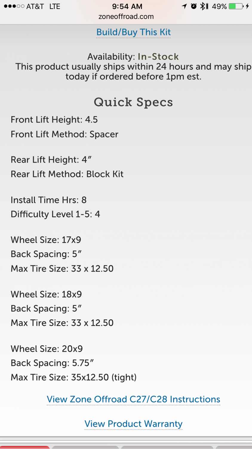

Looks really good Nate. Im sold. Gonna get some quotes this weekend. Still trying to see If I can get 35s on stock wheels with the 4.5 lift

You're looking at the zone 4.5 for a 2014+ GM 1500, right? What size wheels do you have now? Here's a screenshot of their specs for that kit. I suggest calling them and telling them what it is you're wanting to do and see what they advise. I called BDS before selecting my kit and they had a lot of good info. I just stuck to the tire spec they recommend with my size wheel and lift and I have no issues. No rubbing or trimming.

I have these http://www.texastrucktire.com/uploads/4/4/9/1/44915107/s160087193180611566_p5_i1_w640.jpeg 20" stock. I see the 4.5 can squeezed the 35s with this setup. although this is not ideally what id like but I want to keep that stock look to see what it looks like. Does anyone have that setup 4.5 with 35s and stock 20s?

Got mine back yesterday.
Zone 4.5" Lift
Method Racing "Standards", 20x9, +18mm offset
BFG AT KO2 285/65R20
Really haven't had any rubbing yet at all. I *thought* there was a little when backing out of a spot yesterday at full lock but it may have just been the road. No signs of it anywhere.
