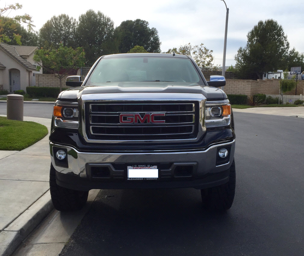

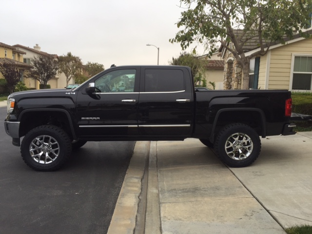

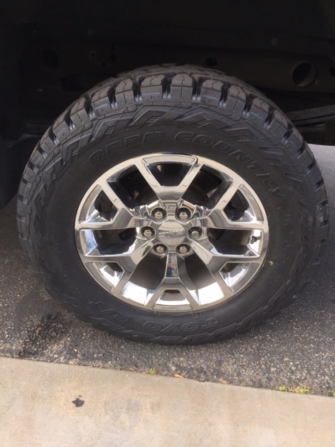

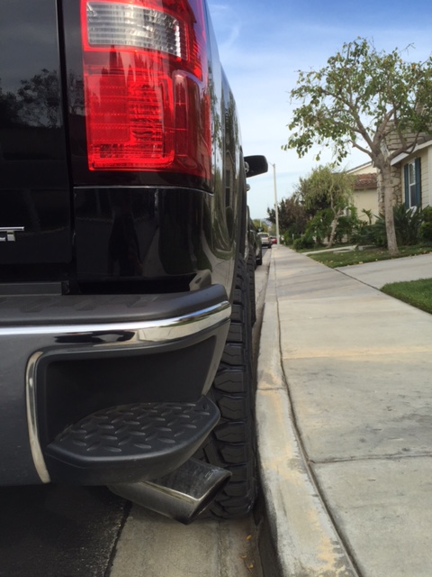

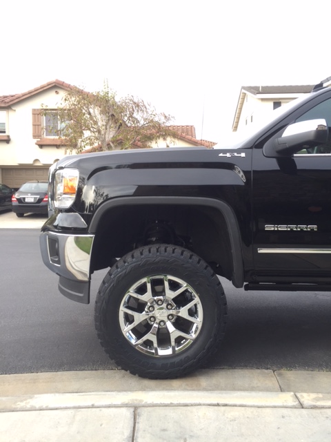

Before and after of 6" BDS lift with Toyo RT 35x12.50r20 tires with stock 20x9 wheels. I used the block lift option in the rear with no leafs or spacers. There is no rubbing or trimming required. I also replaced the stock chrome side step with the AMP power steps. I'll post more pictures when I take it out for some light break in off road! There is a slight rake to the truck (rear is an inch lower than the front when measuring center of wheel to fender. I might do an add a leaf to make it level; especially since I tow.

Nice job Pooj! Looks awesome man!
Hey guys, just an update. Drove her from North Carolina to Florida and the ride was good. Gas was bad as expected haha averaged about 12mpg but I did like riding as high as the semis. I definitely reccommend this kit to anyone considering 35s or bigger. You can always start with 35s on 8 inches or 7 with some rake and have the option to go taller and with a body lift can run up to 38s without major cutting.
Looks good Nate. Anymore pics, side view, track width shots?
I have taken pictures nearly every day this past week! haha! I get super excited to drive my truck, like a teenager who just got their first car. Here are more pictures. Shoot me a PM if you want a better side shot of the track width than what is below. I can take one tomorrow for you. I asked a dozen guys a dozen questions about their trucks when deciding what to do with mine and don't mind paying it forward!
