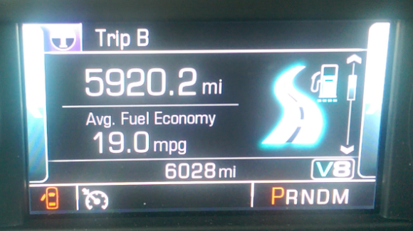

I have averaged 19.5 for the first 2 tanks on mine under normal rural driving.

Not sure if I just got a good batch of gas or what but I just got my best "normal week" tanks to date.
405 miles
21.23 gallons
19.08 MPG.....man I love this motor!
