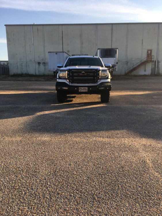

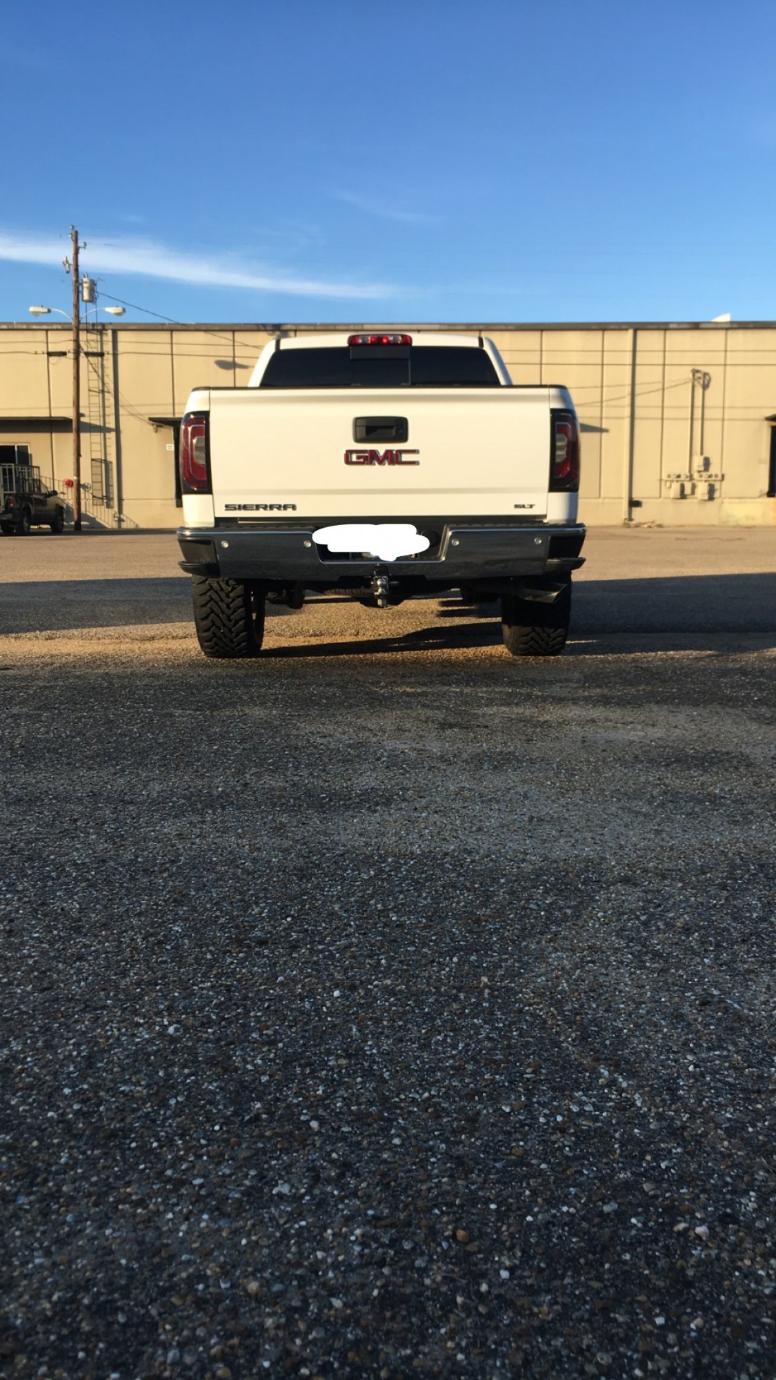

Not the best photo. Got new tires on this weekend. Went from 295/55R20 cooper stt pro to 295/60R20 Toyo MTs
id like to see a picture of the front and rear of this truck. Ive got a 3.25in level on mine with the knuckle and diff drop, and contemplating doing 35s or 295/60.
3 hours ago, bburnsed_12 said:
id like to see a picture of the front and rear of this truck. Ive got a 3.25in level on mine with the knuckle and diff drop, and contemplating doing 35s or 295/60.IMG-0750.thumb.JPG.e2e8b2ec92530ecdfa1d3d6d08de76f6.JPGIMG-0748.thumb.JPG.fb05db41f4f3f3ed209e49d794552ae1.JPG

Sorry for some reason would not let me post all of those in one post. I am a huge fan of the wider tire look and these do not bother me only being 11.7 wide
