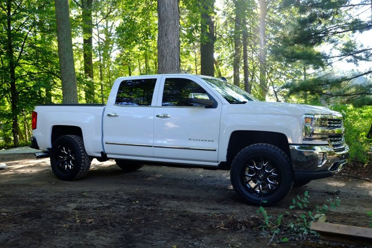

SSchup Posted February 18, 2019 Posted February 18, 2019 On 2/17/2019 at 5:56 PM, Detroit_vs_Everyone said: Fox 2.0 IFP Coilovers best level option? Just ordered 20 x 9 0 offset Hostile Rage with 33 x 12.5 Nitto Ridge Grapplers from Custom Offsets. They will be here in 2 weeks and need to decide on what level kit to go with. A local 4x4 shop recommended Fox 2.0 IFP Performance Coilovers. They quoted 1500 installed front and rear and said these would provide 2" lift with best on/off road ride quality. This is my daily driver and looking for best ride quality along with a lift to fit new wheel tire. What do you all think? Is this a good price? Does anyone have experience with this suspension level? Should I be looking at any other options?? Sent from my SM-N950U using Tapatalk You should be good with that set up. I was running the same Fox 2.0's and the Hostile Rages in 20x9 0 offset with Toyo RT's in 285/60/20 and rubbed the rear inner fender pretty good. These were a 33 1/2" tire. I ended up running a 1/4" spacer on top of the Fox 2.0's to get a 2 1/2" level and still had to tie back my liners. I payed $800.00 for the Fox 2.0's from Performance lifts and installed them my self in under three hours including changing out my UCA's to Reklez UCA's. Here is a picture of my truck with the 2.0's. 1
Detroit_vs_Everyone Posted February 19, 2019 Posted February 19, 2019 You should be good with that set up. I was running the same Fox 2.0's and the Hostile Rages in 20x9 0 offset with Toyo RT's in 285/60/20 and rubbed the rear inner fender pretty good. These were a 33 1/2" tire. I ended up running a 1/4" spacer on top of the Fox 2.0's to get a 2 1/2" level and still had to tie back my liners. I payed $800.00 for the Fox 2.0's from Performance lifts and installed them my self in under three hours including changing out my UCA's to Reklez UCA's. Here is a picture of my truck with the 2.0's. Damn your truck looks great! Makes me even more excited for my order to come in. Thanks for the info on the foxs. Glad to hear you were able to get er done on your own. I will have to about that a bit more... I'm just not all that mechanically inclined tbh. I'm planning on some trimming and a lil tuck. Do u think i.will have to use a spacer as well?Sent from my SM-N950U using Tapatalk 1
SSchup Posted February 19, 2019 Posted February 19, 2019 6 hours ago, Detroit_vs_Everyone said: Damn your truck looks great! Makes me even more excited for my order to come in. Thanks for the info on the foxs. Glad to hear you were able to get er done on your own. I will have to about that a bit more... I'm just not all that mechanically inclined tbh. I'm planning on some trimming and a lil tuck. Do u think i.will have to use a spacer as well? Sent from my SM-N950U using Tapatalk You may not need the spacer with the 33x12.50 due to it being about an inch less diameter tire. 1
