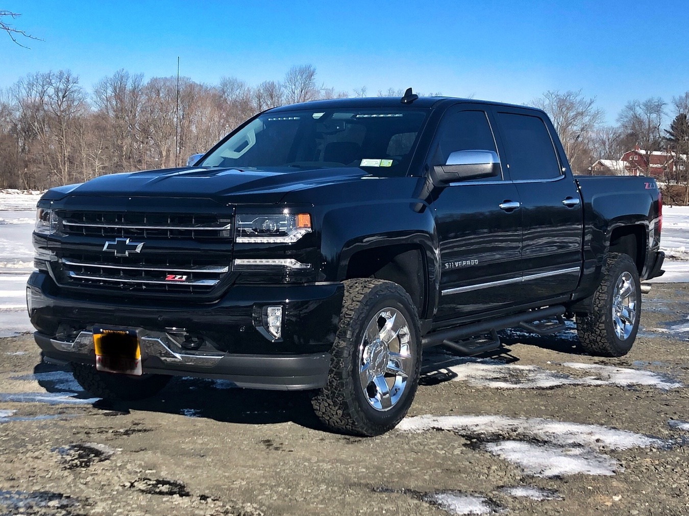

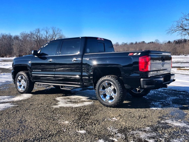

I went with the ReadyLift 2.25 up front and swapped the rear 1.25 for the ready lift 2.25 based on the recommendation of those above. Came out good I think. If anything I would have liked a little higher in the front but matched with the new KO2’s its like a new truck. Ride quality seems unchanged so far as well.

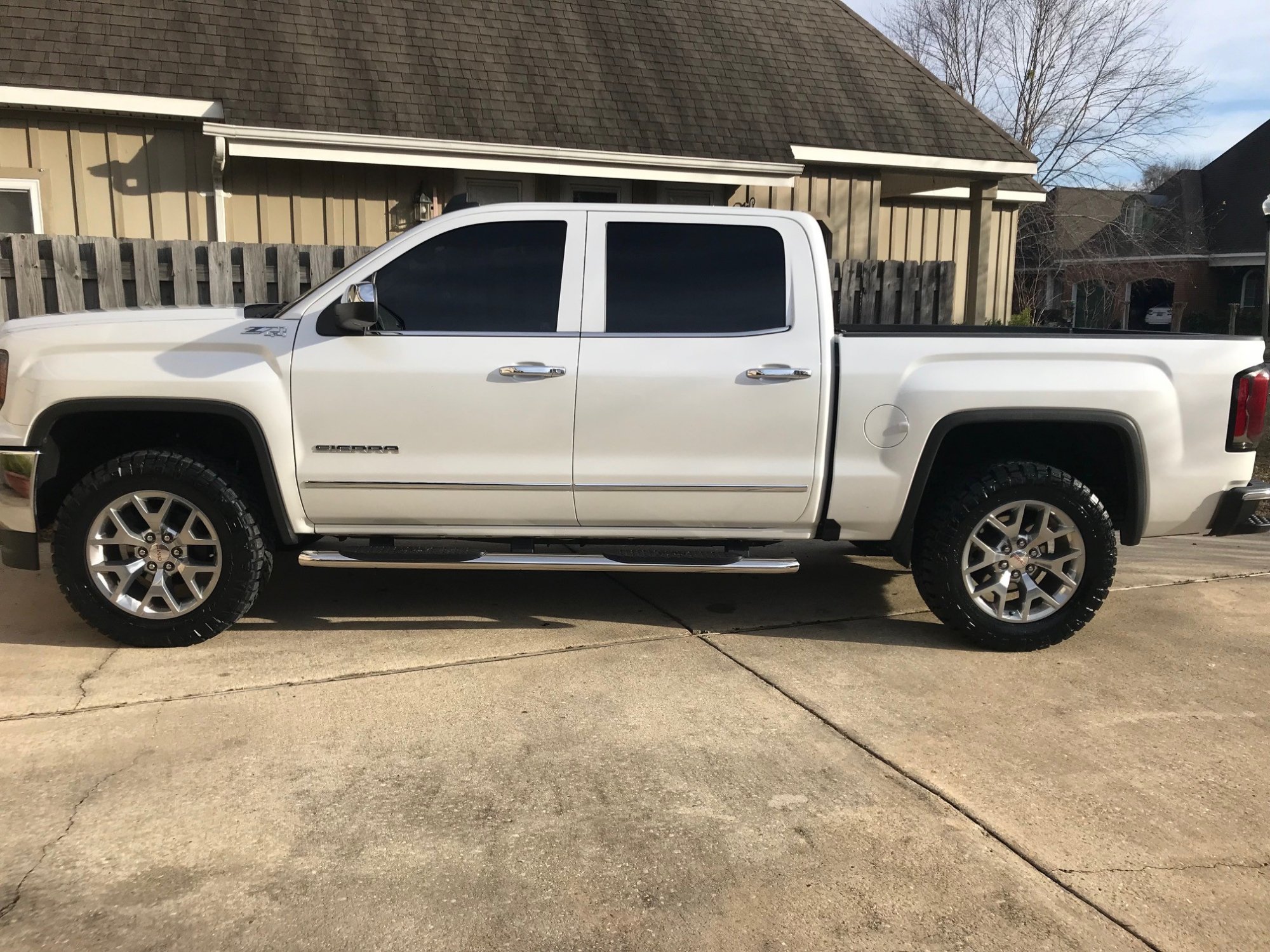

I installed the moto fab 2.5 leveling kit. Ride quality didnt change. Added some Ballistic Rage 20x10 -19 offset from custom wheel offsets. Turned out pretty good. Still sits a tad high in the rear.IMG_2547.thumb.jpg.18d98b85e26c6ebe7963f3712e986734.jpg
Looks good! What size tire and whats the ground to fender measurements if you don't mind
Sent from my SM-G950W using Tapatalk
I will measure tomorrow. The Tires are Trail Blades XT. They are 33x12.50. Slight rubbing in reverse at full lock.

Looks awesome. I have the ready lift 2.25 as well with the control arms. I want to do the rear 2.25 blocks next. What size tires are those? And offset on the wheel? I am contemplating going with a +27mm oem 20" with 275 65 20 duratrac. I want to avoid rubbing. I have the 22's at +24 now with 285 45 22 with .5" spacers and no rub. Not many opetions for the 22's that will not rub. I would love to run 305 45 22, but man they are not cheap, i would hate to spend the money and then they rub.m. Also note that I have a double cab, not crew.

Thanks i am happy with the setup so far. The tires are BF KO2s 275/60/20 with the stock 20” wheels. When I first took the truck for a ride after the install i had a slight rub on the readylift arms at full lock but it seems it is gone after less than 10 miles now. Hopefully it stays that way i was a little disappointed with that. I didnt want to do wheel spacers or anything like that. The stock tires were 275/55/20 so i guess not much room to go up in aspect ratio but in my opinion the tire fits the wheel well just how I wanted it at the 60 size

I rub with 275-60/20 on stock 27mm wheels, so I would say you would definitely rub with 275-65/20’s
